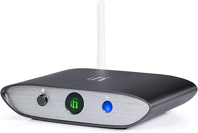

How about something like the Zen blue from iFi. This has a digital output for an external DAC.
The Zen Blue that james_n recommended would be a good choice as it supports aptX, aptX HD, LDAC and also AAC codecs. This is important as the MacBook can use aptX (HD), but the iPad cannot. The iPad uses AAC if the BT receiver can, but as far as I know only for AAC music files (not for mp3 or flac files). Still, having AAC in the receiver is good, as otherwise it always falls back to the poor SBC, even if the files are AAC.

If it`s all about Music I will use my USB-C Audioquest
the zen can do all I need
