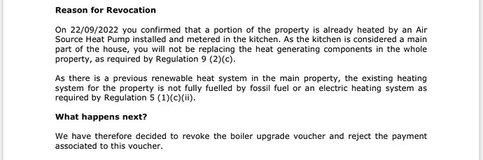

We are changing our heating at home to add a second ASHP and water heating boiler to replace existing electric fueled heating/hot water systems. We were issued a £5k voucher for this by OFGEM earlier in the year, but subsequently they suspended the voucher, pending answers to a lot more questions about our install. I found out today that they are rescinding the voucher.
There are lots of details here that I have mentioned yet, of course, but I note that the decision is open for Appeal.

In my case, they are revoking it because I already have a heat pump at the property. We had it installed 4 years ago to run a few radiators and a large area of underfloor heating. The rest of the house and the house hot water is still on the old system (electric storage heaters and electric tank heater).
The new heat pump is to convert the rest of the house (and on a completely separate system to the existing heat pump), but OFGEM seem to be interpreting the regulations such that a grant can only be awarded if new heat pump is for the whole property and replaces all of the existing heating system in the whole property. From my reading of the regulations, it seems that such an interpretation is not necessary (but I’m not an expert).
There is an appeal process, but I am not sure I want to put myself through the emotional investment (with no clue as to the likelihood of success). It’s been dragging on for months already and other work in the house has now been stopped pending the outcome of this issue.
I guess the scheme believes properties only have one boiler and therefore can’t compute 2.

In my case, our house (built 1934) was brought up to spec epc-wise prior to installing the first heat pump in 2018, so that’s not the issue.
The reasons given in our letter from Ofgem:
We were issued the £5k “voucher” on 22 August and instructed the company to proceed. Ofgem then raised further questions with us, so we put the installation on hold. The revocation is dated 25 October.
In our case, we do not have gas or oil, the entire property is electricity only (3 phase, in our case - made our options in solar/batteries/car charging a little broader). So, while ASHP might not be the best answer for all properties, it seems the best solution in our situation.
Just very frustrating. The parts of the regulations they refer to do not, to my reading, require the “entire property” or the “entire heating system”. It is not clear that this is the spirit of the legislation either, although there is one part that suggests that the heat pump must be “capable of” supplying all of the heating and hot water requirements of the property. Note, “capable of”, not “arranged to”, but maybe that’s a technicality.
Anyway, I think I just have to take this on the chin. They have been a complete nightmare to deal with and if I proceed with an appeal, there is no indication that it will be successful, but it will definitely lead to another 3+ months delay.
