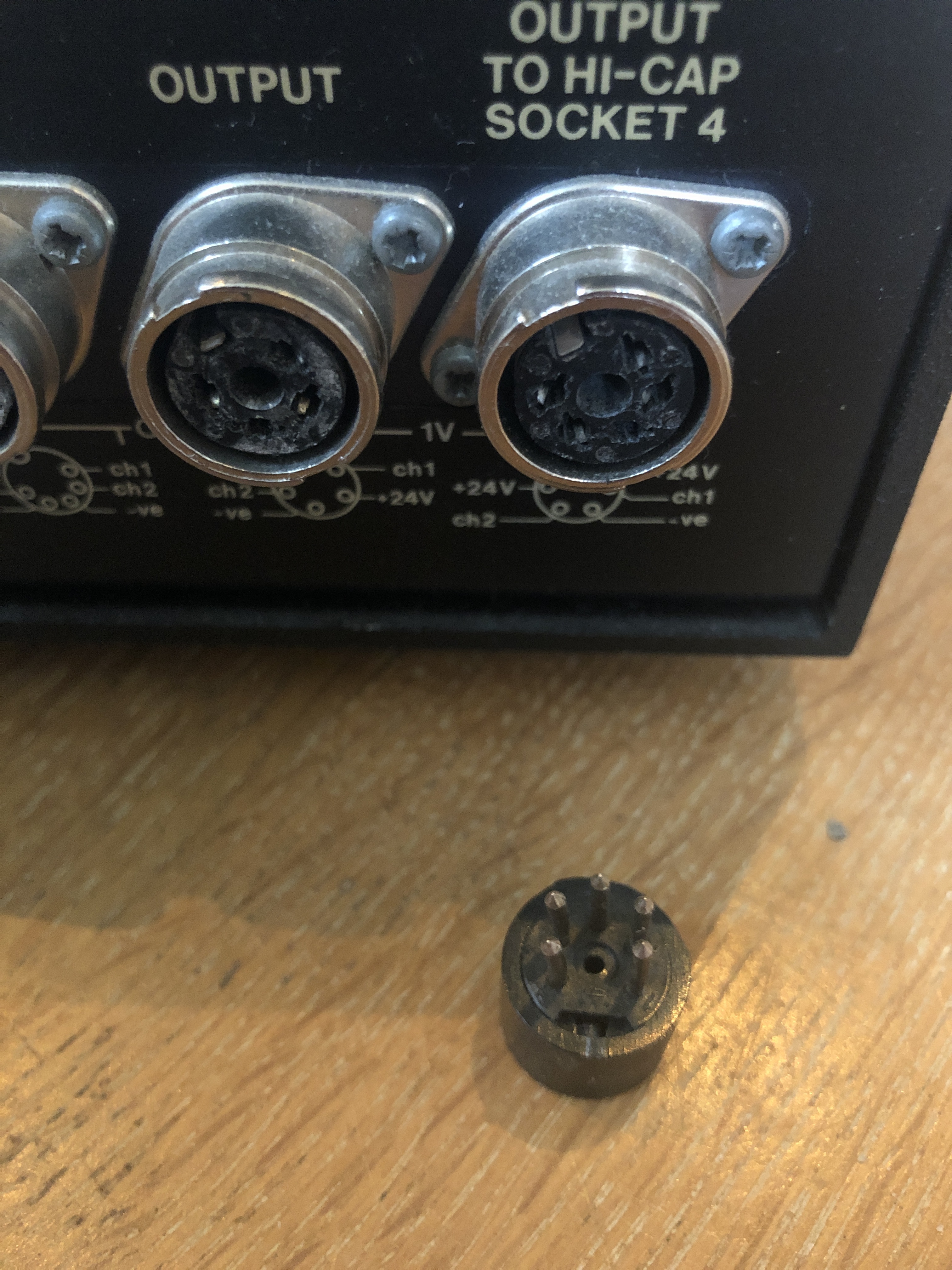

Well it’s a good job i checked naim kit before i bought the speakers because it seems the hi cap has packed up. They’ve been in storage for about 15 years and it’s true what they say " if you don’t use it, you’ll loose it." When i turned on the hi cap for the '72 the logo/display flickered and the fizzled out and died. I put a multi meter for output voltage of the hi cap and there was zero volts (supposed to be 24v) but the logo/display was still lit up. I checked the '72 with a super cap from my main system and that lit up. I’m sure the 140 is okay because when i switched it off the speakers popped like they normally do when you switch it off (more tests later). Now i know you can run the '72 with the 140 without the hi cap but you need the “blanking plug” if i remember correctly, that fits into the '72 ? I’ve just got remember where that plug is.
That’s it 5 pin. Thank you.
