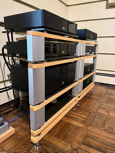

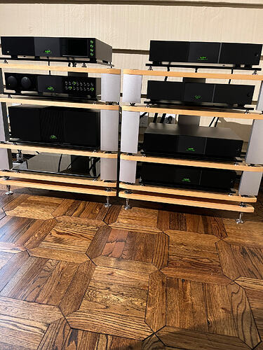

My Fraim setup:
Left Right
Nd555 Nd555ps
552 dr 500ps
500dr 552ps
Space. Nd555ps
With this setup no burndies touch floor
David
I found that having my cds3 head unit above the 552 was not a good idea. Far better moving it away onto another stack. Maybe the streamers are better than cd players in this regard?

Hi David Thanks for the photos and the reply. A picture paints a thousand words or so they say :+1:
