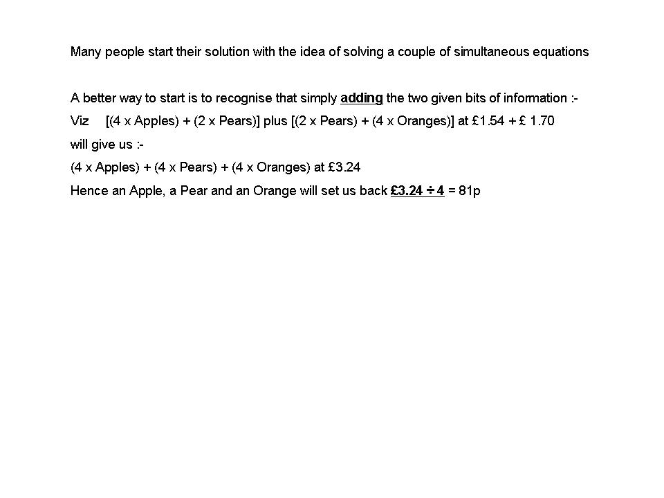

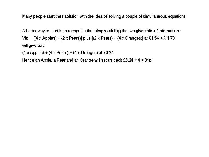

My Apples & Oranges solution.

Well done Mike !!

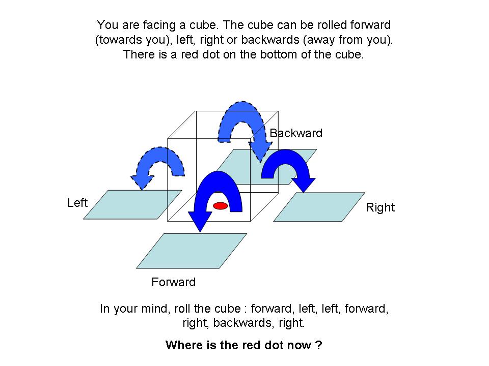

I think:
  • the dot is at the bottom again
  • you should take the other door
