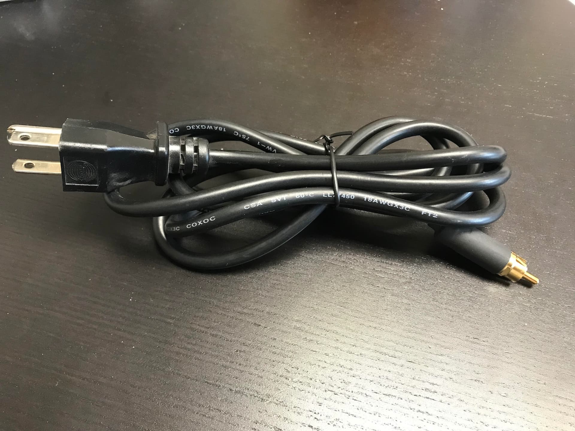

Former Naim & Focal employee commenting: a NAIT will almost always hum if it is not grounded by a source unit. It has been a while but I believe it’s the input stage that is floating (?). Here are two images from yesteryear (Not to worry, the blades of the AC connector are not connected):

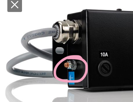

Instead of relying on tape holding the wire to an rca socket, the XS3 has a dedicated ground post on the back.
Loosen that off, wrap the wire round and then tighten up again.
