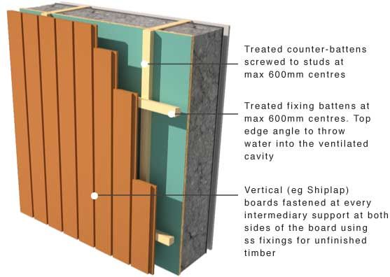

When I get around to cladding my garden room, I’ll staple the membrane to the framework and then nail the cladding onto a series of counter-battens (to allow for airflow):
