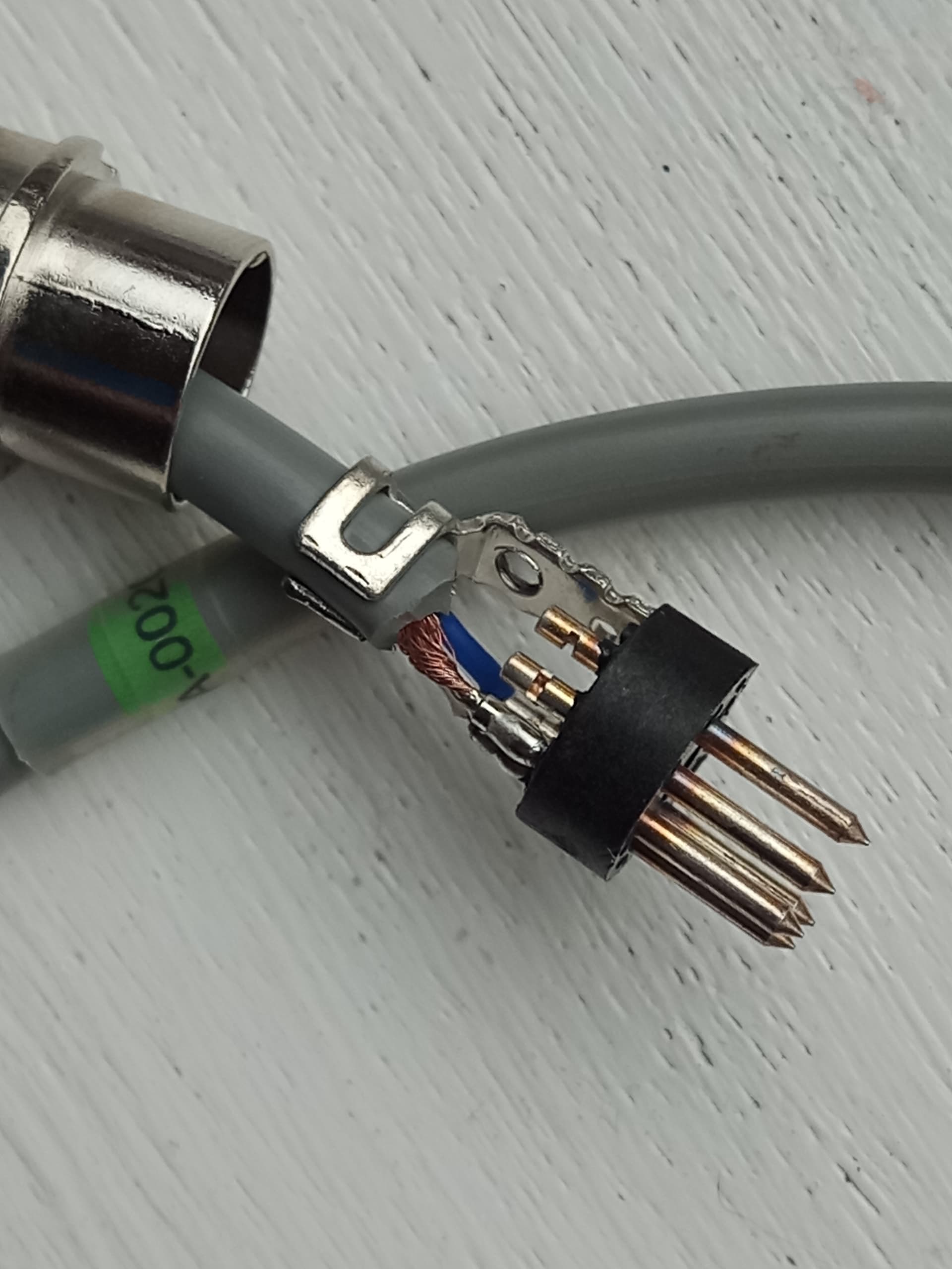

My case is building a 3,5mm Stereo Jack to DIN Input lead. I already have several suitable DIN plugs, removed from other things or brand new. My 3,5mm REAN jack was £2-65, my Van Damme cable was £2-00.
I may post pictures of my lead, once I have the Jack Plug & cable… :astonished:

I have also re-worked some cables, to suit my usage. My Naim NAC to Rega Ear headphone amp is one. It began as a Chord 4 pin DIN to Phono (so the directionality faeries were aligned…) - I swapped out the 4 pin DIN for a 5 pin 180 degree.
All of the above only have 3 cables connected in the din plug.
Err, no… not in my book… :thinking:
Each will have 2 pair of wires (for L & R input and L & R output), plus 1 screen - which is 5. This is assuming Stereo connections, in each direction.
An input only or output only cable will have just 3 wires, yes. Or 2 wires and a screen.
I am confident of this… But… YMMV… :crazy_face:

I am talking about we might call Tape leads - for a Tape recorder, or similar. Which have 4 wires and a screen - and say 4 Phono plugs on one end.
That… is an input cable. Its output pins are not wired.
Would be fine of a CD Player, a Streamer or a DAC - to any Naim NAC.
But of no use for a Headphone amp… :astonished:
I’ve made cables for headphone amp.
Only used 3 pins in the din plug, but not the same pins used in the dac output cable. :blush:
That - is correct - as you know.
And that is where so many go wrong, in buying a cable to feed a Headphone amp… :astonished:
