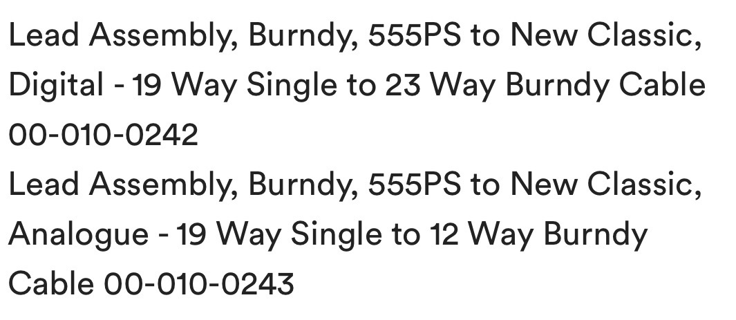

is the digital burndy for the new classic 222 the same cable that was used for the 555PS to an ND 555 or CD555?
hi
No. I needed two new burndy to connect my CD555PSDR to my NSS333.
thanks Blackbird.
I ordered the dual ended cable, and what was delivered was just an analog side burndy. hence the wondering about pin alignment on old burndies and possibility of using the old digital cable…but I have not found any info that that is possible. When you got your burndies, naim sent you two cables…so that is an option in addition to the single cable that powers both inputs on back of 333 and 222? Thanks for the help
Fred
If you wish to connect a 555PS to a 222 or 333, you need a pair of burndies:
I’ve copied this from the FAQ.
