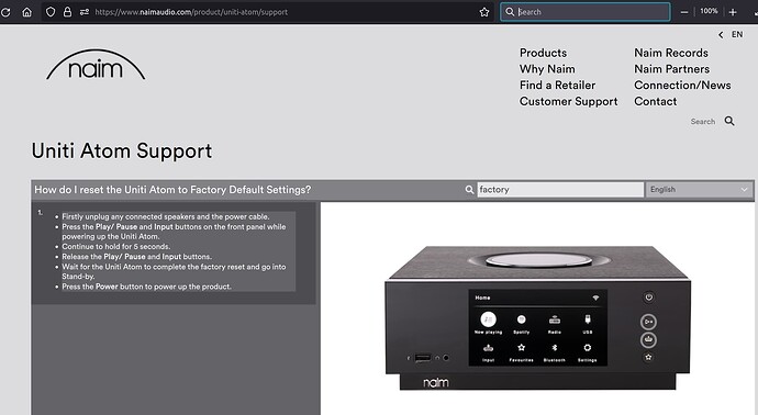

It’s best to do a complete factory reset when buying used gear that allows for it. For the Atom:
Yes, that would have sorted it. Naively I thought the Naim dealer had done it before sale. Anyway all good now.

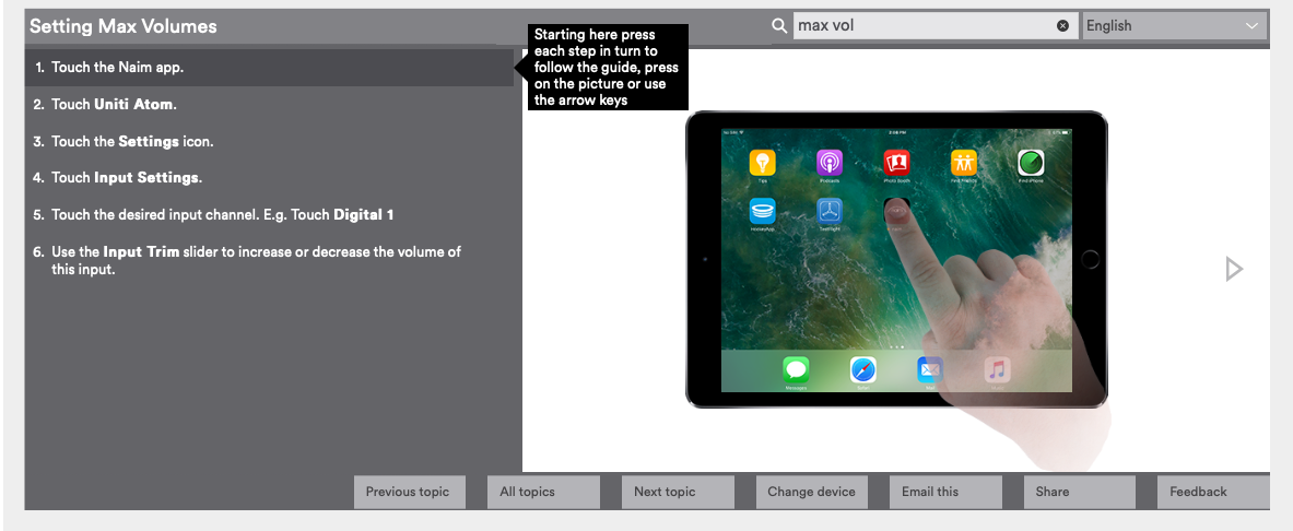

If you haven’t seen it there is a sort of interactive ‘Support guide’ which goes into a lot more detail if you click the support section here:
I can’t see any mention of the max vol settings but it’s hard to know you’ve entered the correct search term - searches often give several links to info but annoyingly when yoiu choose one you can’t go back to the search results AFAICT and have to search again.

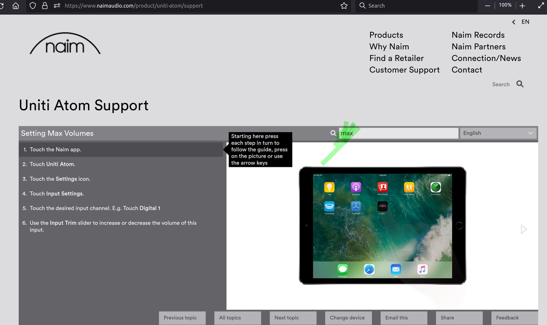

Direct link to support page is:
While it can sometimes be awkward, I find the keywords very reliable. I this case, for instance, “volume”, “max”, “maximum” and combinations all find it:

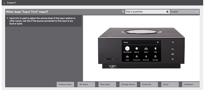

One other thing (which does show up if you search for ‘max vol’ or similar) is ‘Input Trim’.
Each physical input can generally have the gain configured and some have voltage settings.
Might be worth checking the settings if you ever hook up any external sources in case previous user may have changed these too as they may have needed to.
