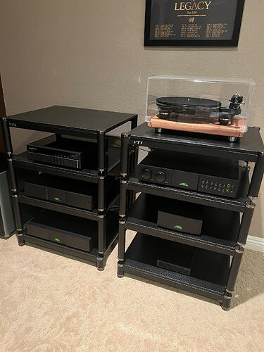

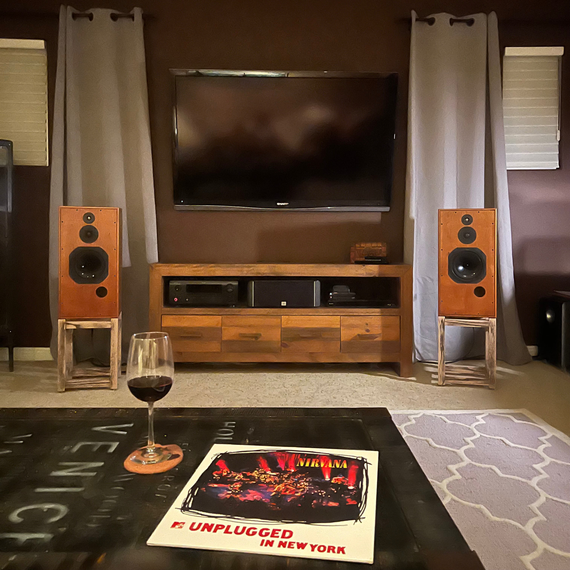

I just moved my system into my new listening room and I love the new set up…but…the rig sounds way too bright compared to before. Now I know a lot has changed…new room, new acoustics and a new rack.
I have a double rack now and I’m wondering if the cable arrangement may be causing some of the new brightness. The room is big with plenty of help with thick carpet, long curtains and a big couch.
So any advice here? Certain cables need to avoid each other or run parallel or orthogonal?
Set up is 252/250/SC (all DR) with Rega P8 and Superline (powered by 252). And a meridian 508 CD player. Harbeth SHL5 XD with NacA5
A5.
The biggest effect of a room on acoustics tends to be it’s dimensions. You can’t change that significantly be making minor tweaks to cables and soft furnishings, although minor improvements aren’t impossible.
I would start by experimenting with room layout in general, and especially loudspeaker positioning. If that doesn’t improve things sufficiently or you can’t do it in a way that’s practical or aesthetically acceptable, you could try room treatments. These tend to require quite large and bulky absorbers etc. which you may or may not find visually acceptable.
If you have the patience to measure the room acoustics, possibly with some professional help, it will give you an idea of how to design the room rather than just throwing money at it.
Crucially, consider whether the speakers are a good match for your room. I would say that speaker/room interaction is the single most important thing to get right in HiFi, and however much you like what you’ve got, if they don’t integrate well into your room they are not the right choice.

From experience with these speakers, I believe it’s the SHL5 super tweeters in the new room - they tend to be too much of a good thing and may be showing more in your new room. I would try positioning, distance to speakers, listening spot to start with.
May be try some alternative to the NAC A5, would suggest Atlas or Audience and if these are not within budget, may be TQ as they also sound smoother.
