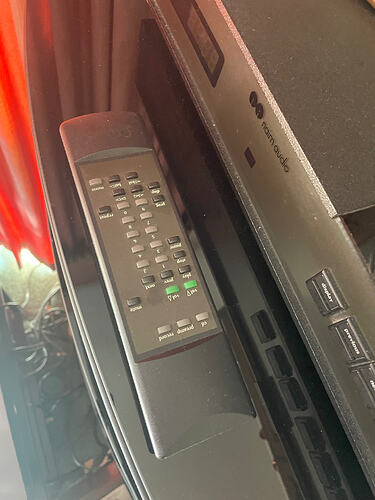

I’ve been thoroughly enjoying my CDS-1 setup recently, especially given how wonderfully these older multi-bit players still perform. However, looking at the reality that spare parts and specialized transport mechanisms are increasingly scarce if anything major gives out, I’m hoping to tap into the collective wisdom of other olive-era CDP owners.
What proactive steps is everyone taking to keep these players healthy for the long haul?
Specifically, I’m curious about the power routine: are you keeping your CDPs and power supplies powered on 24/7 in line with traditional Naim philosophy, or are you shutting them down when not in use to preserve the laser assemblies, displays, and aging power supply caps?
Would love to hear what strategies and maintenance routines have worked best for keeping your units running strong.
