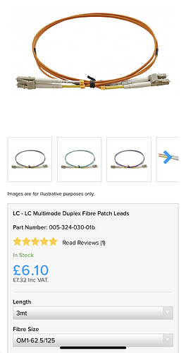

The SFP you would need is a GLC-SX-MM. It will take LC connectors on an OM1 cable, which is readily available from the likes of Cable Monkey.
The genuine Cisco SFPs are, like the switches, quite expensive, but can be found cheap on ebay. Best to get genuine Cisco ones, as some third party copies require you to log into the switch and enable them.

I thought the difficulty was to choose the right optical cable which will work both with ER and Cisco.
Thanks Bluesfan
Hi FR,
I suspect the objective difficulty can be overcome by searching for ā€œOM1 LC to LC fibre optic cableā€ in your favourite search engine.
The largest psychological challenge may be that they cost about £15 for a 3m length, rather than £1500.
Best regards, BF
I remember @Darkebear who related that one specific fiber he tried didn’t worked with his Etheregen and Cisco.
Perhaps @charlesphoto knows which cable will work from Cisco to Etheregen.
Or it’s just what you said: LC to LC fiber will be fine.
OM1 fibre with LC connectors is all you need.
Chrissu, are you sure that multi mode will work with Naim streamers? Because one member tried in the past multi mode with tp link, it was @obsydian, and it didn’t work ( with Nova).
Yes, it’s what I use between Catalyst switches, and it works perfectly.
There was an issue with some TP Link FMCs where people were trying to use GB models into the 100MB network port on a Naim streamer, which wouldn’t work. You needed a 100MB FMC. Perhaps that was the problem?
