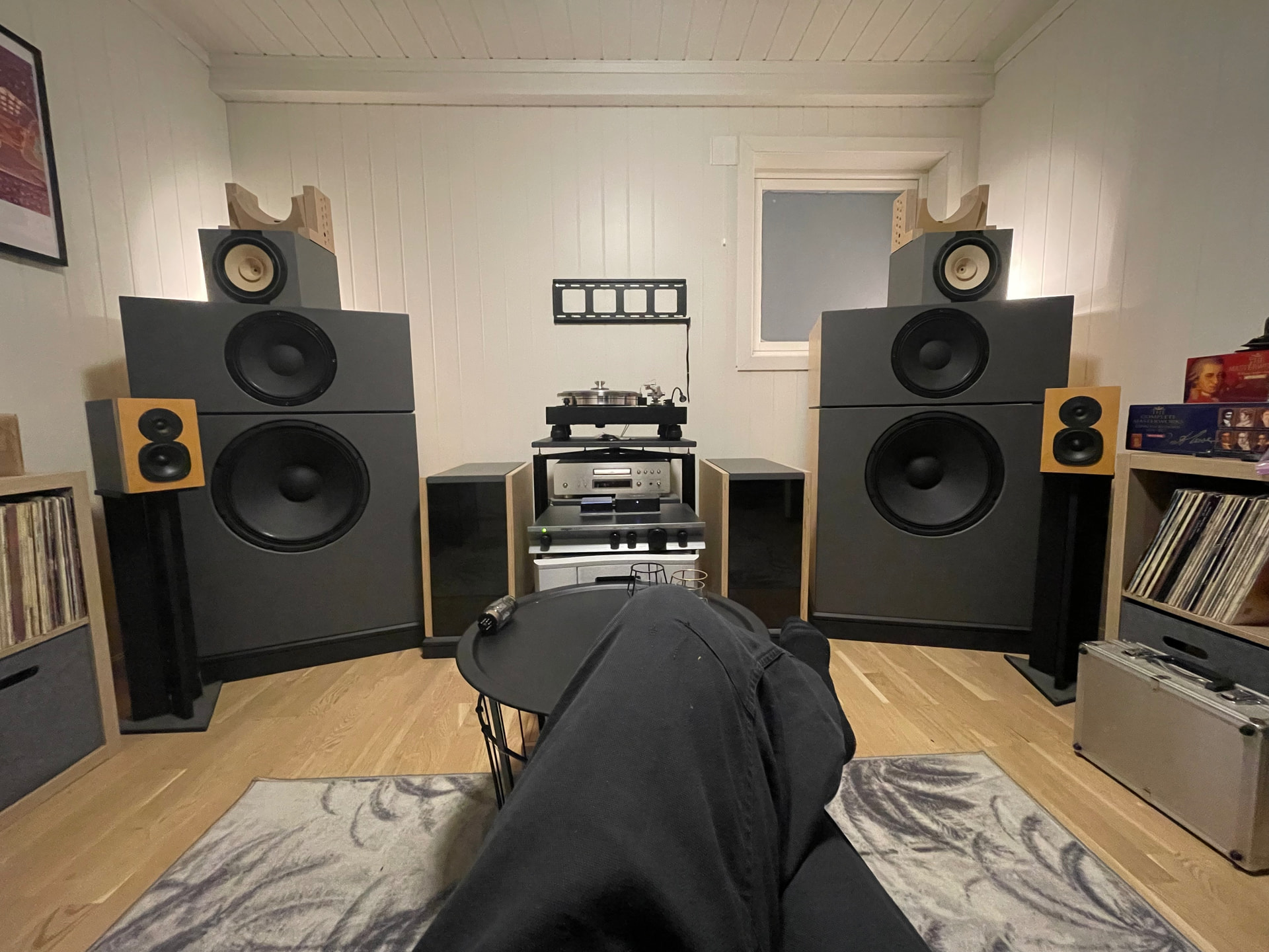

A friend of mine play on these in a 3x4m room. Bass drivers is 18". Cabinet is 80x80x60.
I feel that if you have a small room, you need small speakers, is a myth.

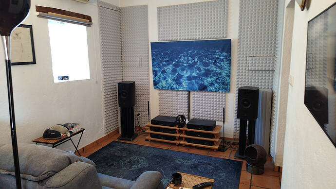

The smallest space I’ve ever equipped. When I moved here my then system included Proac D15 floor-standing, ported speakers. They sounded dreadful. Unfocused, diffuse and lacking in everything that had made them stunning in a bigger room (in a different country).
As I had to buy locally in a land 99.9% empty of anything resembling hifi audio at the time, the only demo-available speakers on offer were Harbeth (I forget which model) or ATC SCM19’s. These were both linked into a NAIM Atom - nowhere near the performance level of multi-box system so I had to perform some mental gymnastics and magical thinking to imagine how each would perform in my home setup. I settled for the ATC’s even though I suspected that the 11’s might be a better choice. They turned out to be perfect, following what, as you can see is an aesthetic failure for some on here, but in every practical sense a perfect sound-baffling erection (opportunity for Skeptical, there :wink:). The listening space is 3x3.5 metres. And before you ask, it’s a biofuel heater…
I also settled on ATC 19’s MikeD
I did demo the 11’s but the 19’s just ticked all the boxes but if I could only afford the 11’s I would have happily lived with them
I see you have your 19’s quite close to rear and side walls and I know from my own experience that they are not too fussy about placement
I actually found that in a small space, placement became crucial. Even a centimetre can make a difference, although they are mismatched deliberately to help counterbalance drastic bass and treble loss in
one ear (hence my current pursuance of getting back the hifi WOW experience with headphones).
Before the hearing loss, this was the best placement in my small listening space.

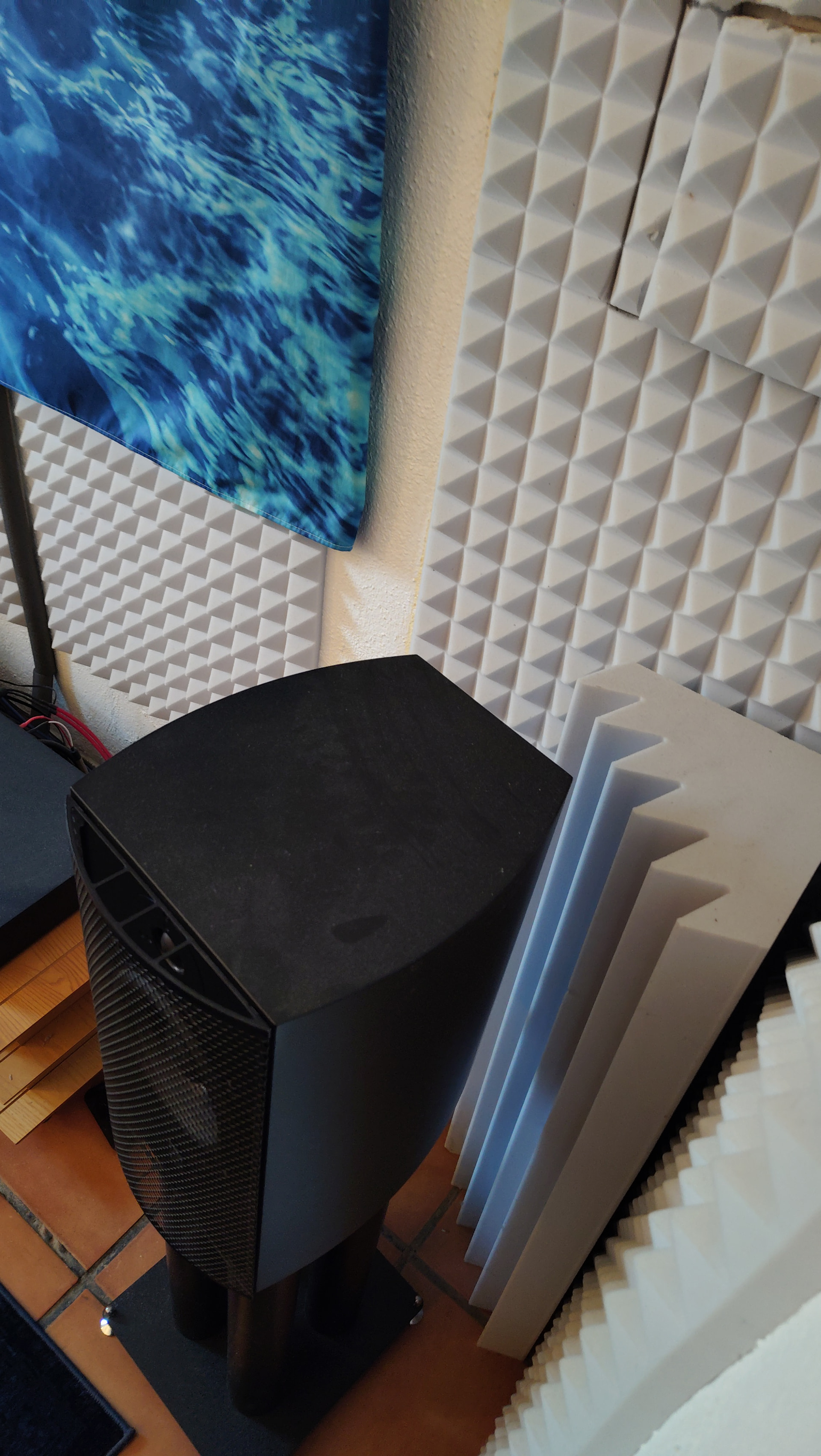

I’ve seen you post this a number of times now & seeing as this goes against the norm, do you happen to have any pics of the previous room treatments? Often times when this is the case, its normally caused from people using improper treatments & often seemingly just placed randomly. Obviously a good recipe for a poor outcome.
I can’t work out how they are mismatched, I presume it is distances at the side to the wall and rear to the wall. By how much?
The left one is back on the stand with the front of the speaker in line with the stand top plate. The right one is as far forward as it can go without falling off.
