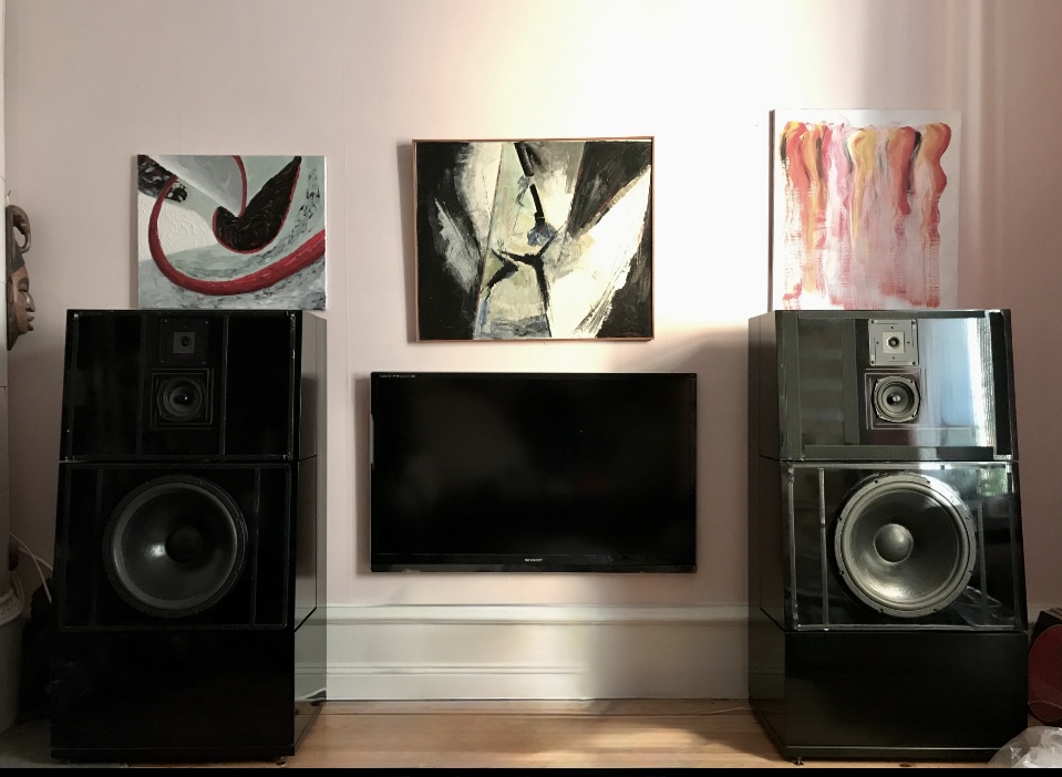

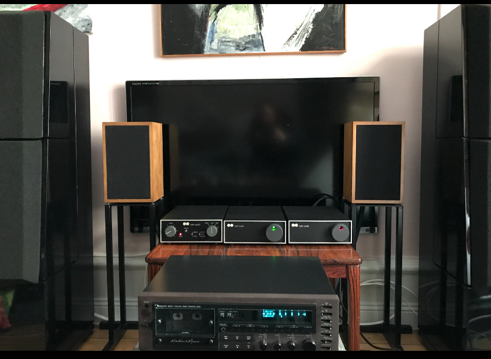

I have roughly 5 x 3.5 m in a non uniform room. I find ls3/5a and variant speakers work well… I also use bass sinks in the corners behind speakers. I have speakers pointing up the longest dimension.
With small rooms you need to be mindful of wall reflections as well as ceiling.. assuming you use underlay and carpet. I use natural plaster as opposed to skimmed plasterboard on ceiling which seems to work well. Pictures on walls helps, ie anything to disrupt smooth uniform surfaces as well as soft furnishings.
