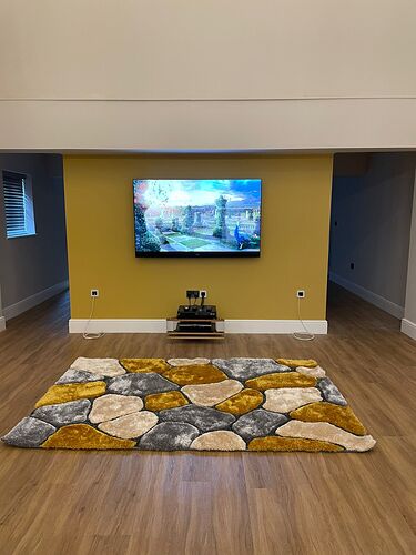

Yes, of course you can, can you see my cables :blush:
Now that’s how you do it!
That’s super neat and impressive did you do anything special in the wall? Or do you think mine will be fine in just the plastic pipe/tube?

Yours will be fine, mine’s a false wall to hide the cabling etc. There’s 30m of Kudos speaker cables, HDMI’s and fibre optics for the AV cable behind that wall :slight_smile:

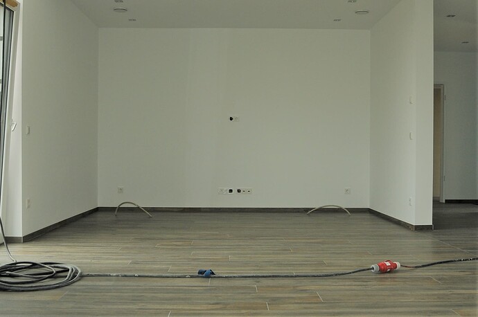

We had empty tubes installed before furniture and hifi moved in, that way the cables disappear into the wall and only re-appear underneath the speaker stands.
