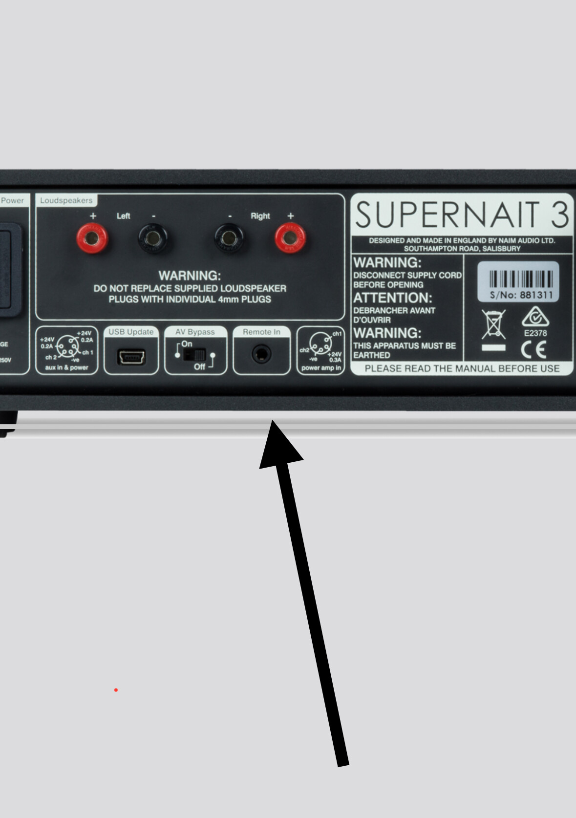

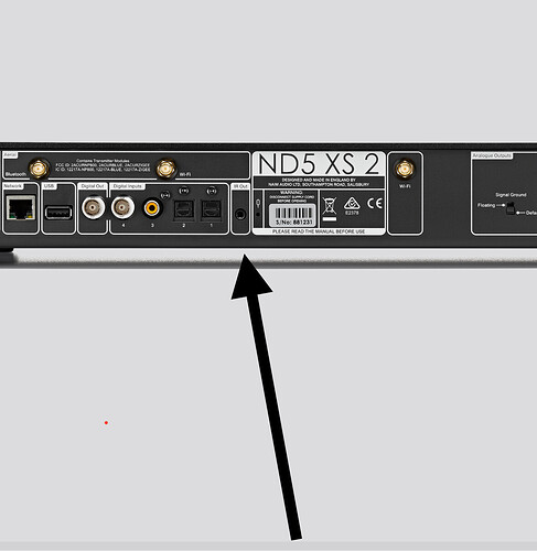

Supernait to NDX2 needs a 3.5mm to 3.5mm cable.
Both 3.5mm stereo (much more choice) and (harder to find) 3.5mm mono will work just as well.
Cable quality (cost) has no effect, just look for something thats not too long and fits your setup.
@HungryHalibut it’s not about the cable cost. That is trivial. My disabilities preclude me doing it myself. It would, in my case, require a home visit from the dealer’s staff, for which there would be a charge. I could wait until the system needs more attention which might not be for a while, since it’s brand new.
Do you not have a friend or relative who could connect the little cable for you? It’s very simple. It’s a simple 3.5mm to 3.5mm cable, and it goes between these two sockets:
