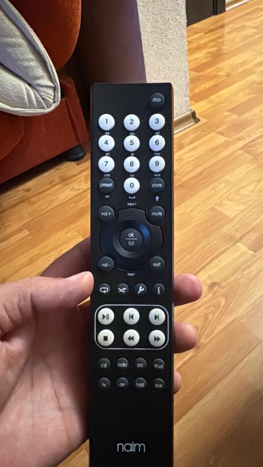

Hello everyone! I have Naim ND5 XS and a ir remote handset, but I cannot pair both. Remote is with fresh batteries. I made factory reset to Naim streamer and after that remote doesn’t work. What I’m doing wrong?
Edit: added photo of the ir- handset.

Hello, Richard! Thank you for your response!. I tried everything above, 3 or 4 times, without success. Replacing batteries, factory reset, pairing with combinations of Aux+Display, 1+Display… Doesn’t work. When I enter Remote control settings in the streamer, I see codes are changing when I press any button on the ir-remote handset. But nothing else.
OK, I wonder whether @NeilS is able to advise further here
I’m sure that remote unit worked before I did factory reset (because I bought the streamer from a friend). When I look into the ir-sensor trough my phone camera, I can see it blinks.
It would appear that the instructions on the web link above are incorrect. :astonished_face:
To match the remote with the default unit IR code, press “Aux” “i” & “Disp” simultaneously.
I will report the error.
Regards
Neil.
Thank you so much, Neal! You’re GREAT! It works now!!!
