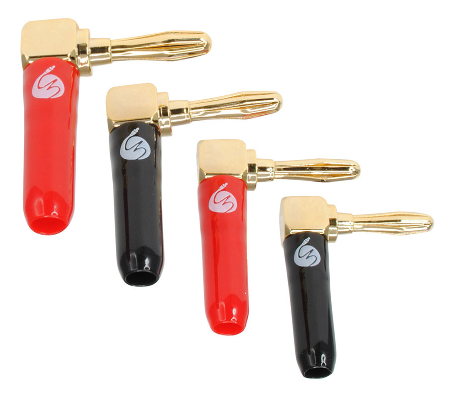

The best solution to stop banana’s pulling out of speakers is the Naim 90 degree angled banana plug. The 90 degree angle takes the straight line pull away. It works really well but the speakers need to have the banana terminals spaced at 19mm (thats an ISO standard of some sort).
Or if the Naim plugs don’t fit, there are various 90 degree banana’s on the www market.

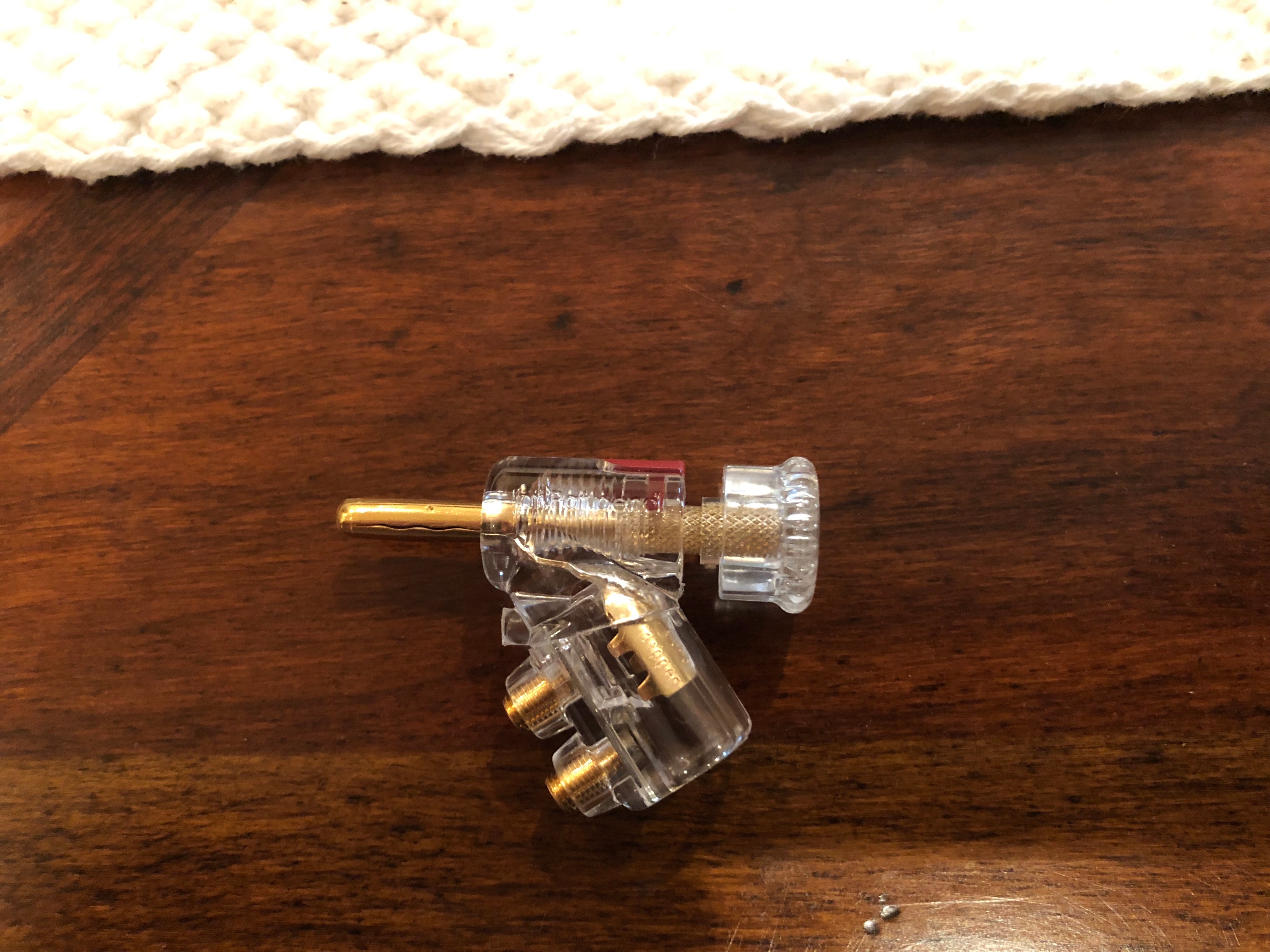

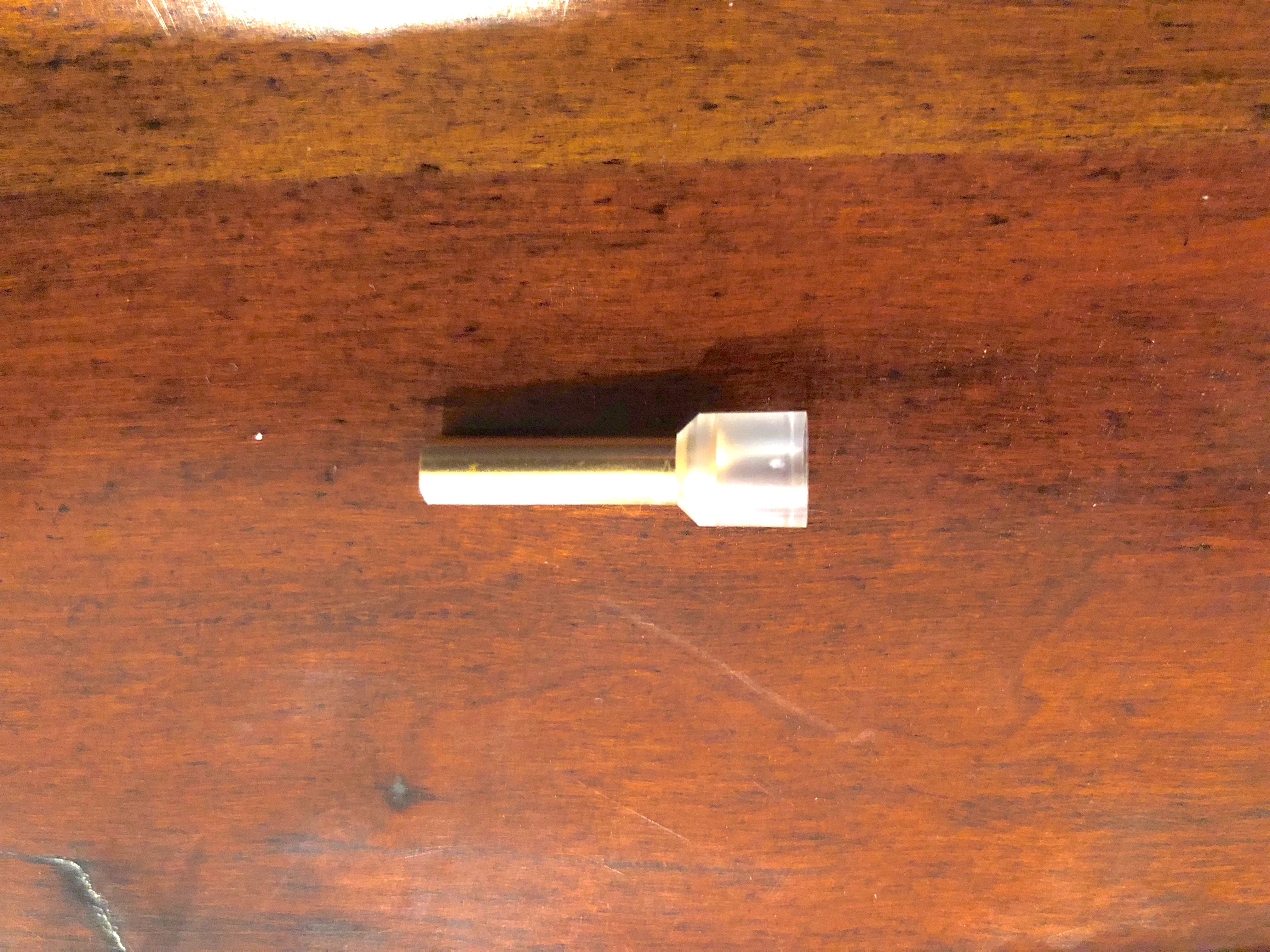

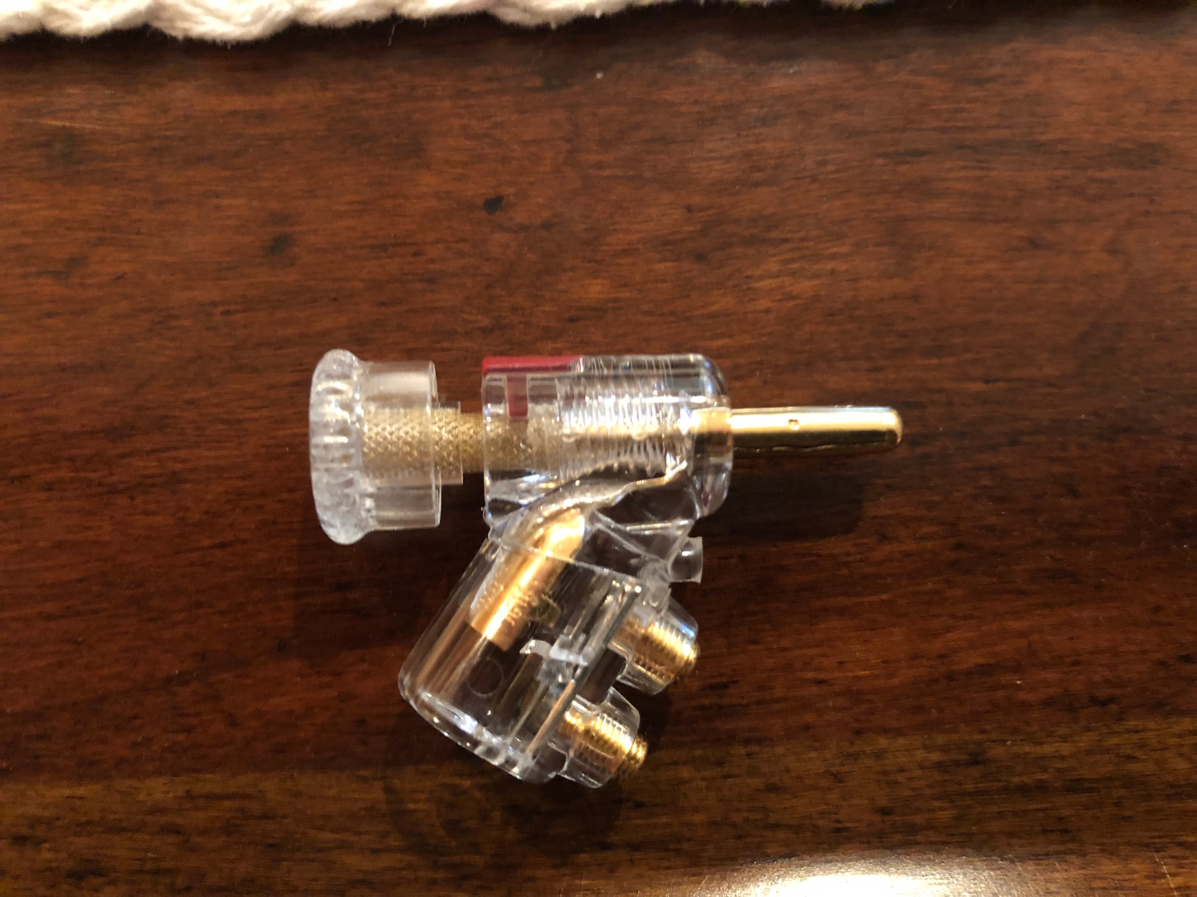

I like and use WBT’s they are very low mass and are locking. The picture at the bottom is the crimp sleeve. There’s a plastic pin that needs to be removed to use on Naim amps. I use the WBT-0610cu which is a direct gold over copper the New WBT use pure metals for the base no alloys. (upload://bb6DeMRIm0HG0RCiovDBOvbBtkw.jpeg)
Busy couple of days, but thank you all for the suggestions. I had WBT on the Cardas, but with the old design. I verified how much room I had on the floorstanding speakers to see if this arrangement would work. The other plug in the images also looks good. I’ll go for a visit to the local dealership here to see what they carry. I believe my NACA5 may be under 3.5 meters, so I may need to go shopping…
