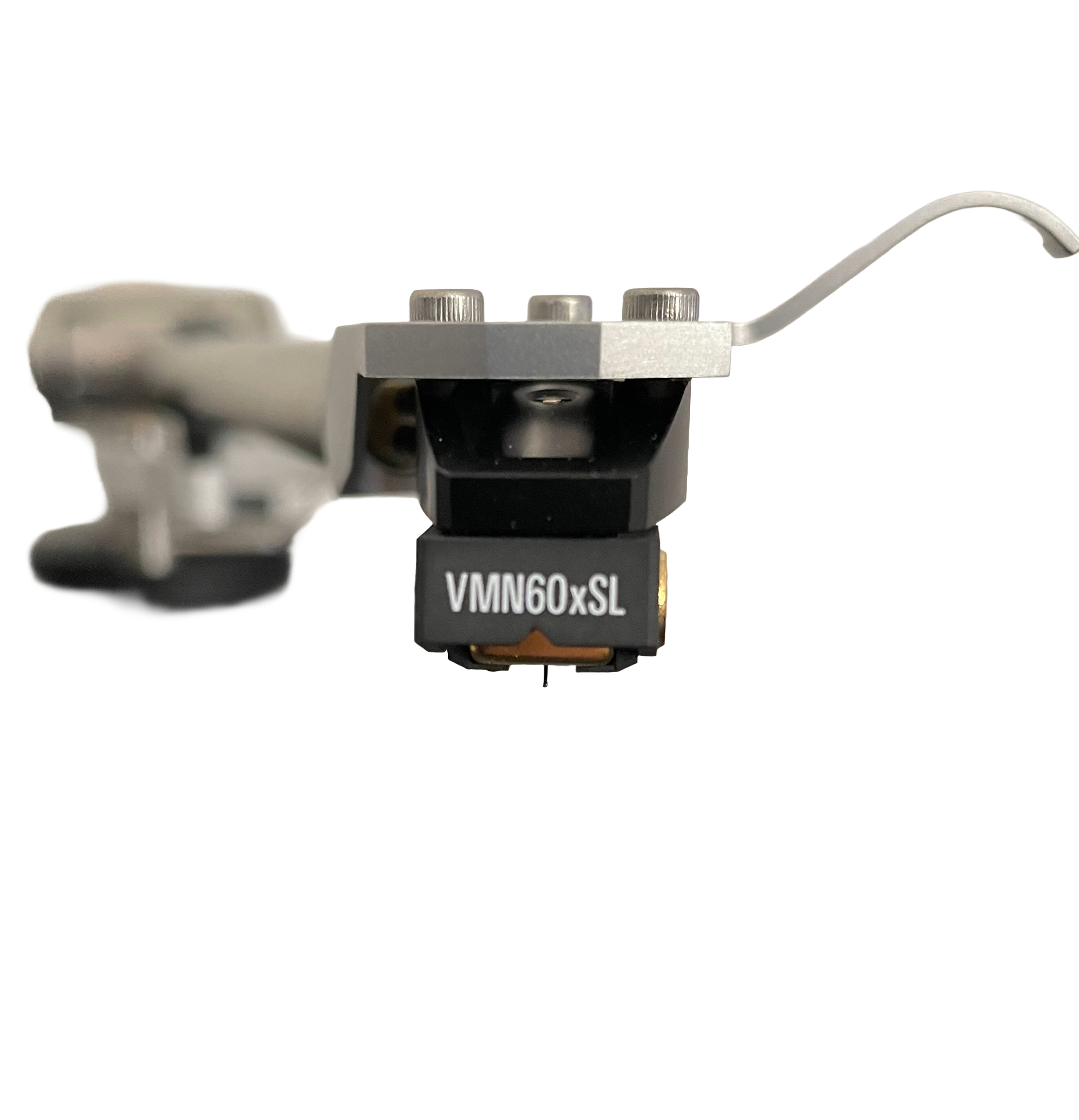

I use SN3 with TrigB, Audio Technica VM760xSL
Sounds amazing and no compromise on output.

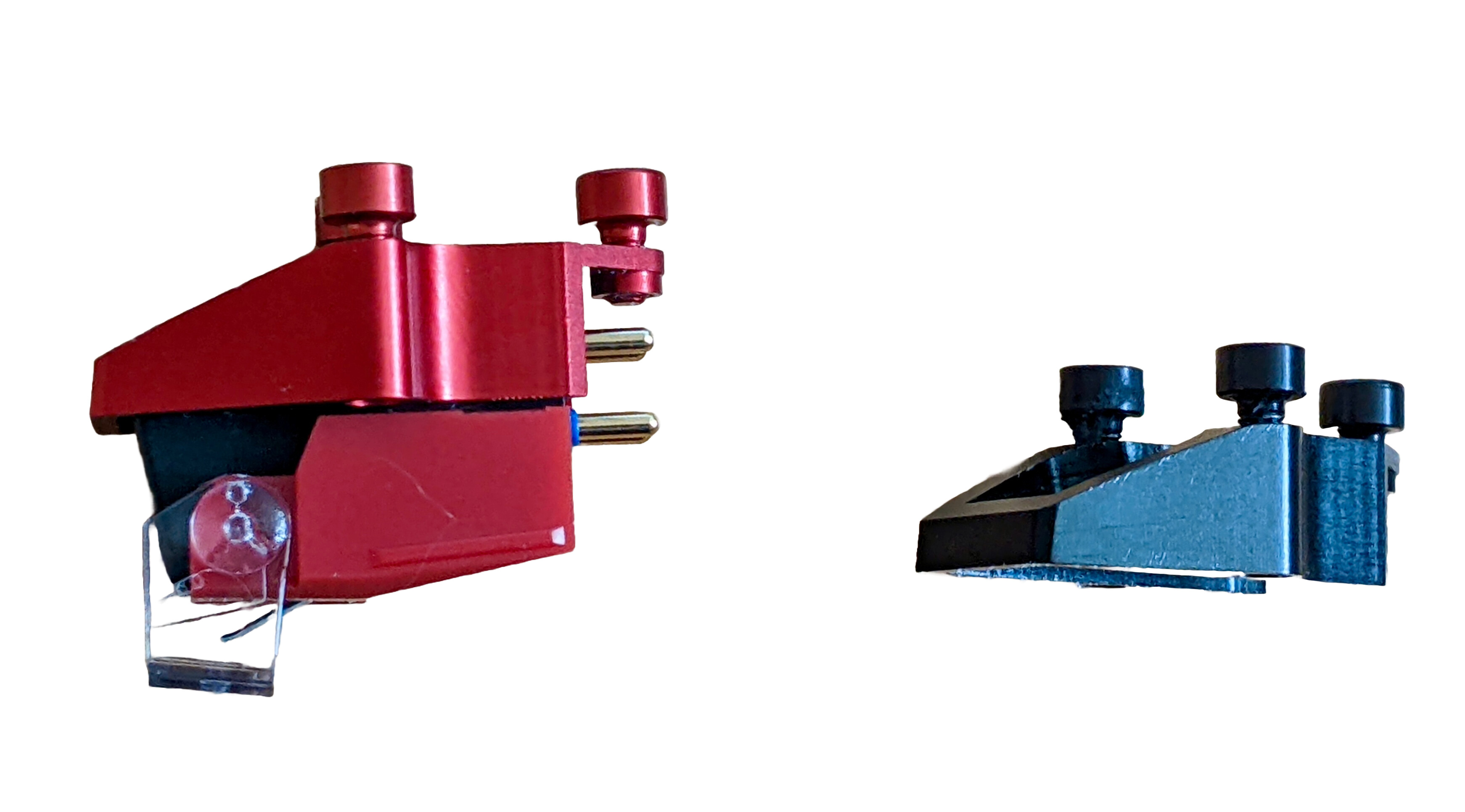

@Skeptikal What is a TrigB?
Hi @Jaybar
It’s a custom made replacement body that is machined from solid to allow my AT cart to use the Linn 3 point mount.
Much more rigid than the standard body.
