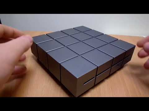

why not something like that, for around 400 GBP:
Astell and Kern cd ripper. with usb c cable .
