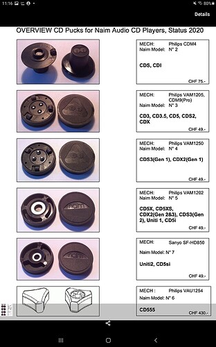

Before buying ensure yourself if Naim have still the mechs for it. For example at the moment there is no mechs for Cds3 repair. Neither Cdx2.

Best to check with Naim first. They only have laser mechs available for their very top end and introductory cd players. The CD5xs is more highly regarded however.
The cd5xs uses the same mechanism as the cd2.2 doesn’t it?
I think @gthack table of info may assist.. or here:
Ere you go :slight_smile:
I’ve had both - the mechanisms look exactly the same.
I believe so yes
+1
