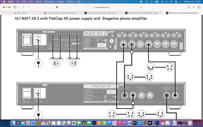

The connections (from the Nait XS2 manual) are as below:
The diagram has a Stageline in place of your CD5XS on output B.
The little square blocks on the ends of the diagram’s Snaics correspond with the coloured bands that are at one end of each of them in reality. In effect, they are direction markers.
Thank you. I haven’t bought the Nait yet so hadn’t seen that particular diagram.

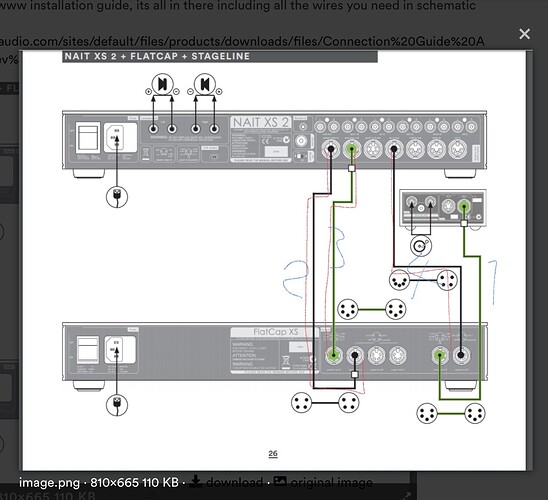

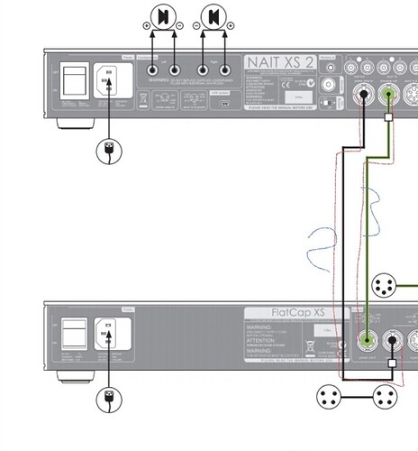

Found it. Thanks again. Please see pic attached. Apologies for my poor editing but it looks like three extra cables required? I only have one between the CD5xs and Flatcap xs and there are 4 cables shown on the diagram. 3 from the Flatcap to the amp and one between the Flatcap and CD player.
You already have a SNAIC5 between FC Power Out B and your CD player.
As Chris mentions, you just need two extra cables to be able to use the FC with the XS2 as well - A SNAIC5 and a SNAIC4.
These are the two cables in your diagram
That’s it.

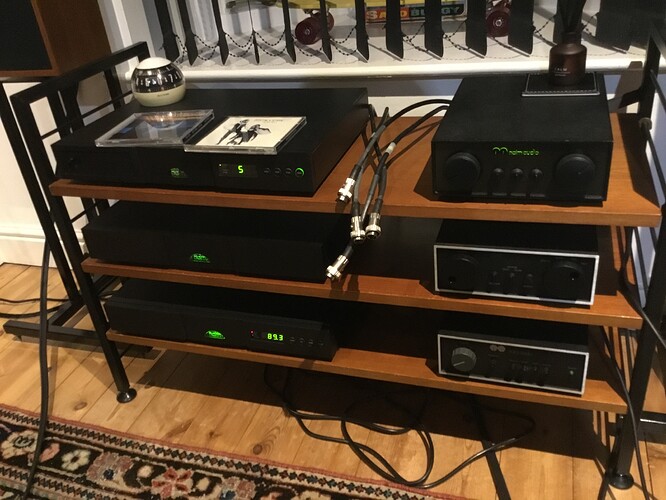

Excellent - that looks a nice set up there. Kans too ?
Assuming that frame is of stuff for sale at the dealer’s shop, please buy the FM radio, bottom left, too ![]()
