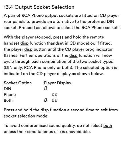

I just dusted off my old CDI with a view to redeploying it after a house move. It fired up fine, CDs spin but there is no sound output. I tried a couple of amps to exclude the bleedin’ obvious, including (cue grimaces) a Sonos purely because the latter reports a connected line-in peripheral in the app (which it does) but no joy.
Am I missing something obvious here or is there anything I can do short of shipping it off for repair or recycling?
I was in the process of saying precisely that…I only have a din output. I should have mentioned, I tried my old Chord interconnect first, which didn’t work. It’s a bit crusty so I ordered a £2.50 one off eBay just to test the player…that’s the one I have connected now.
The CDS, CDS2, CDI, CD2, CDX, CD3 and CD5 only had Din sockets. The evil of RCA phonos only appeared once Naim acquiesced to the desires of the great unwashed with their subsequent players.
