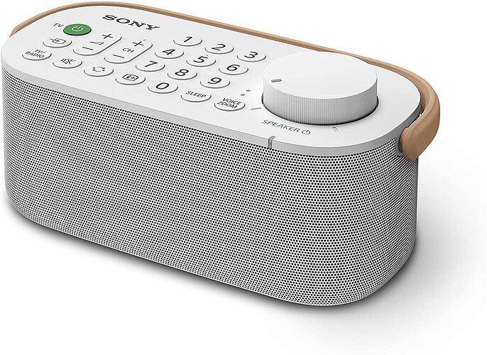

You may be off looking at the Sony Wireless Handy TV Speaker SRS-LSR200. This connects to the TV sound output and is placed next to the person to enhance the sound.

A Muso or soundbase type speaker is generally a full range thing, so I can’t see that helping to make voices stand out more clearly. I can see that a dedicated centre speaker could help, but only if it’s fed from an AV amp with a proper centre channel, with any low frequencies and background sounds sent elsewhere. If that requires a separate AV amp which I suspect might be a step too far. Which I guess brings us back to the little Sony speaker which I can see might work well here.
