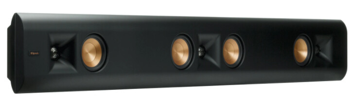

Found something for you:
“3-Channel Sound Bar Provides Left/Center/Right Speakers in Single Seamless Cabinet”
Nearly… if the end speakers were upfiring its a sale… is it a klipch?
Yes Klipsch. I think the best you are going to get is 3 identical centre speakers placed next to each other, end ones firing upwards. Cable entry for the end ones might prove tricky unless you add feet and raise them up from the shelf they’re sat on.
The klipsch product would suggest theres a market for a 3 way single box, maybe atmos is just too new for the designers. I guess passive soundbars are abit niche though.
