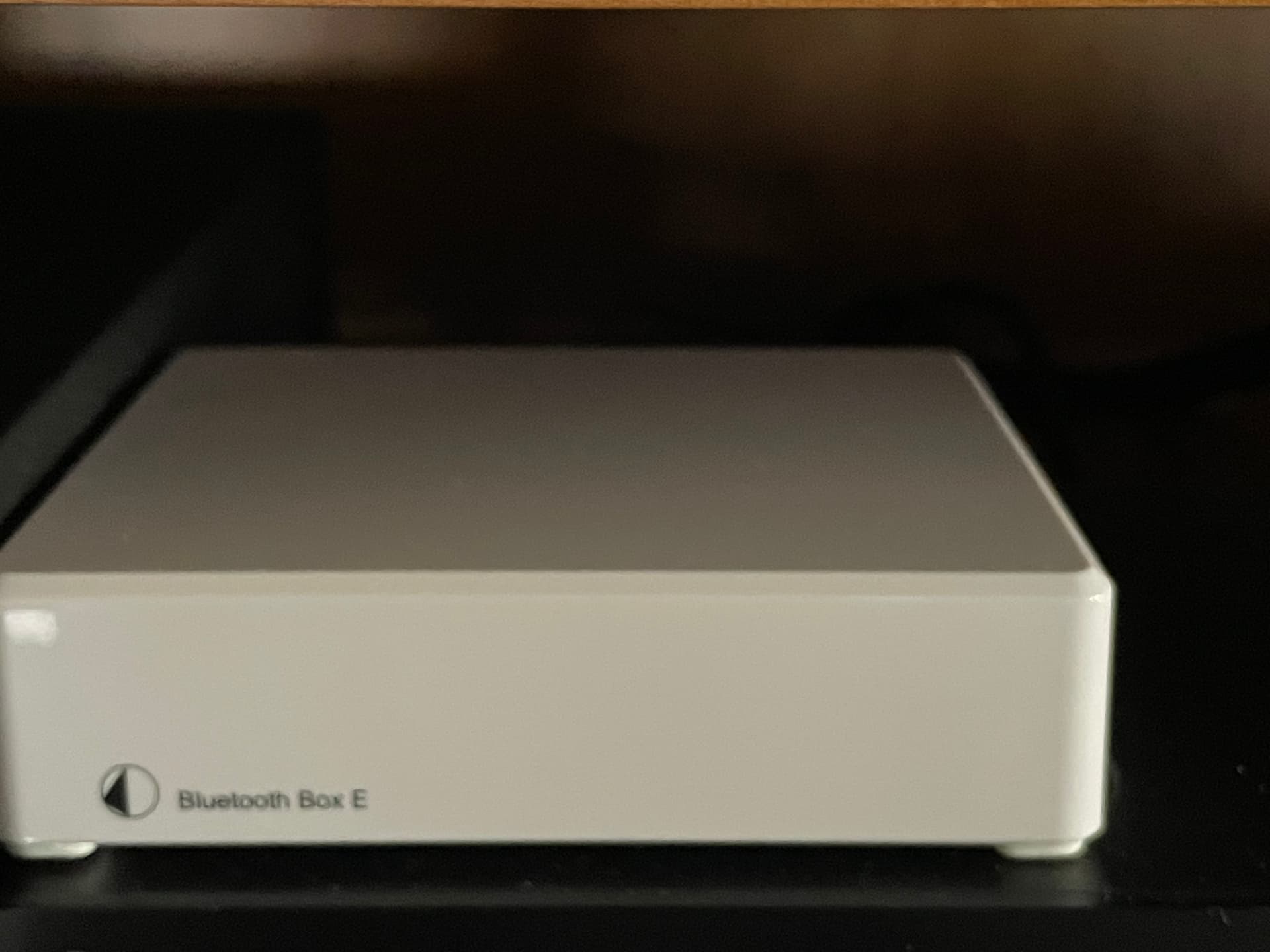

Hi everyone, I listen to a lot of liquid music from Apple Music, and currently as a DAC I use the ProJect BT Box E (see picture) which, considering the price, really works wonders. However, I would like to improve the quality, and I am thinking of replacing it with the new Cambridge DAC Magic 200M, of which I have read excellent reviews. The music source is my iPhone, so I need a Bluetooth DAC. Has anyone had the opportunity to listen to it? Thanks.
