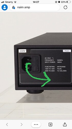

I received new fuses from Naim after whole naim system was down one morning. Powered down system and back again as recommended by technical help desk to find the xps not lit up. I have been trying to open the small fuse box next to the input lead using my smallest screw driver without success. Am I missing something ? Now starting 3rd week with no Quboz and no radio streaming. Paul W
It should open from the left hand side, hinged on the right.
Pulls straight out. Usually a finger nail is all that is required?
No qobuz for three weeks? Cant you power up the internal power supply for your streamer?
Thanks everyone. Old fuse out and 2 new ones inserted and now enjoying radio paradise. This was not designed for people with my size of fingers however. Paul W

The rating and fuse type is printed on the back panel of the XPS. You don’t need to read the rating on the fuse itself.
