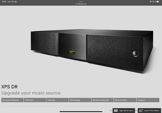

Connecting the XPS to the 272 will improve all the sources. Ultimate is 555PS. The 272 555PS 300DR was the go to at one point. I haven’t heard it myself. However I would definitely put the XPS on the 272 and see how it improves your sources. If you can get another power supply and put it on the CDX2 as well should sound better still. Naim work on Power Supplies!
Important: XPS power supplies with serial numbers below 188015 are not compatible with the NAC-N 272 and should not be used. Contact your local Naim retailer or distributor for more information.

That’s right Dan. The Olive XPS used a transformer from (IIRC) the Supercap. One of the 15V regulators gets close to its thermal limit due to the increased current draw on that rail when a Streamer is used instead of a CD player hence the serial number warning.

Your upgrade path sounds good as long as your XPS is up to the demands of the 272. I have always been thrilled by the improvements a PS can make, add a 250DR and it will be fab. I had an XPS DR’d by Naim a few years ago. Do they still offer that?
