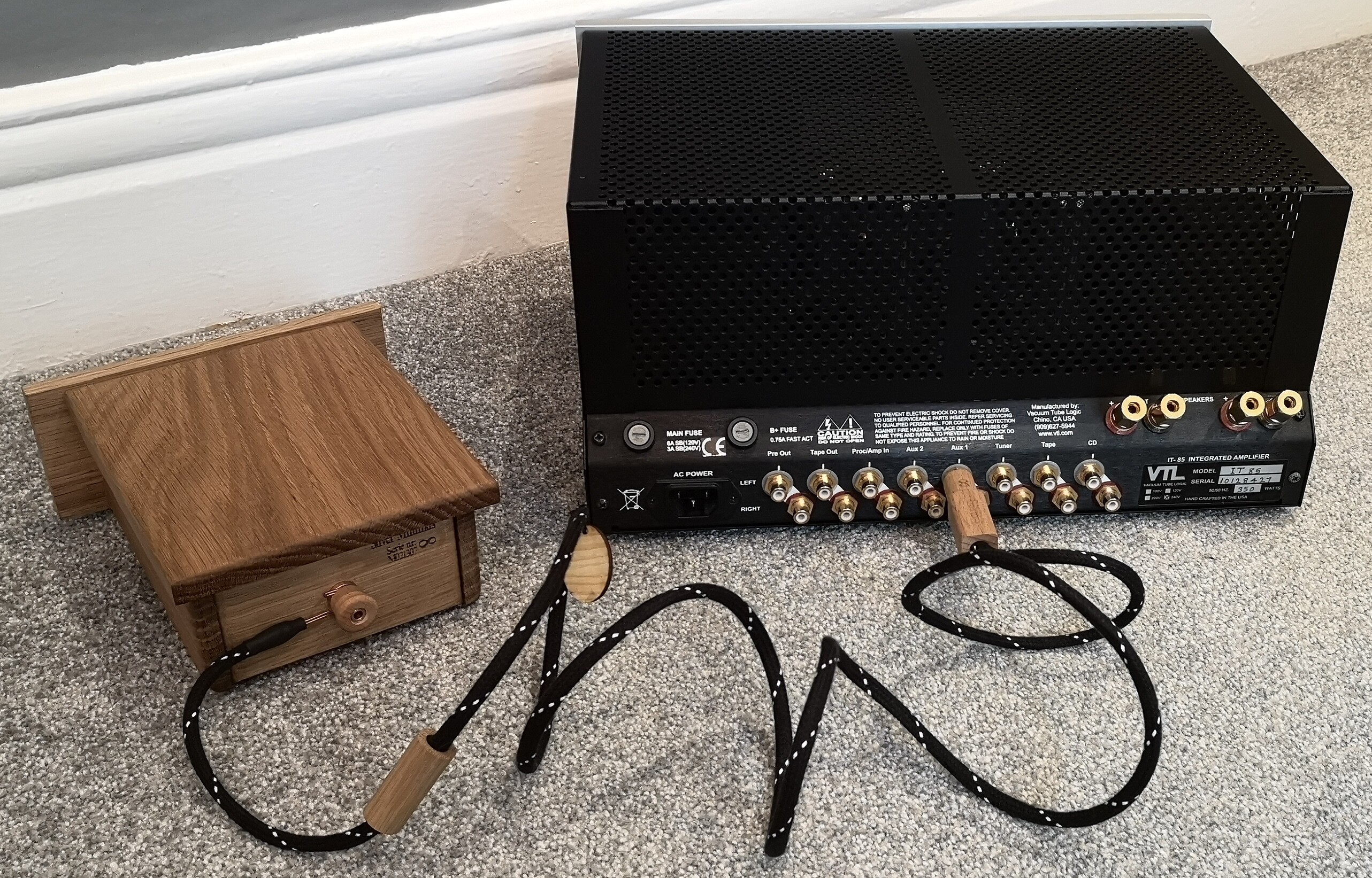

That’s your description of a virtual earth. The virtual earth Entreq are talking about is in a wooden box meters away from the amplifiers.
Oh wow, i just Googled them and it’s literally wooden boxes with dirt? What on earth?

I suspect they are home made. There’s a video on YouTube showing how to make them. I think the ingredients are secret though.
Not possible to tell from the photo if they are effective.:grinning:
We just don’t know.
