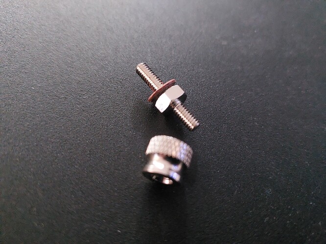

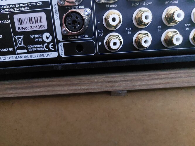

Did I f#+k up??
I unscrewed this plug, and now I can not screw it back in. Should I have squeezed the wire between this screw and plug? I can not feel anything in that hole to tighten it back any more. I am stressed out now.
Yes, I’m not sure how you unscrewed the whole thing ?
The knurled knob (at the bottom of your picture) is what you needed to unscrew. There should be an internal insulating washer, ring terminal and nut inside which looks to have come off.
I suggest getting your dealer to open up the SN3 and put it back on.
Now I feel dumb. But thanks, i think you are right. I saw a picture here without that knurled knob and screw so i thought both needed to come off. I provisionally managed to attach the wire. Hum is gone, now it is only a soft buzz. But I will go to the dealer for repair and a permanent solution. Not my day today
It should be a nice quick job for the dealer to sort out putting the ground post back and as you say, they can then make you up a more permanent solution for the ground wire :+1:
