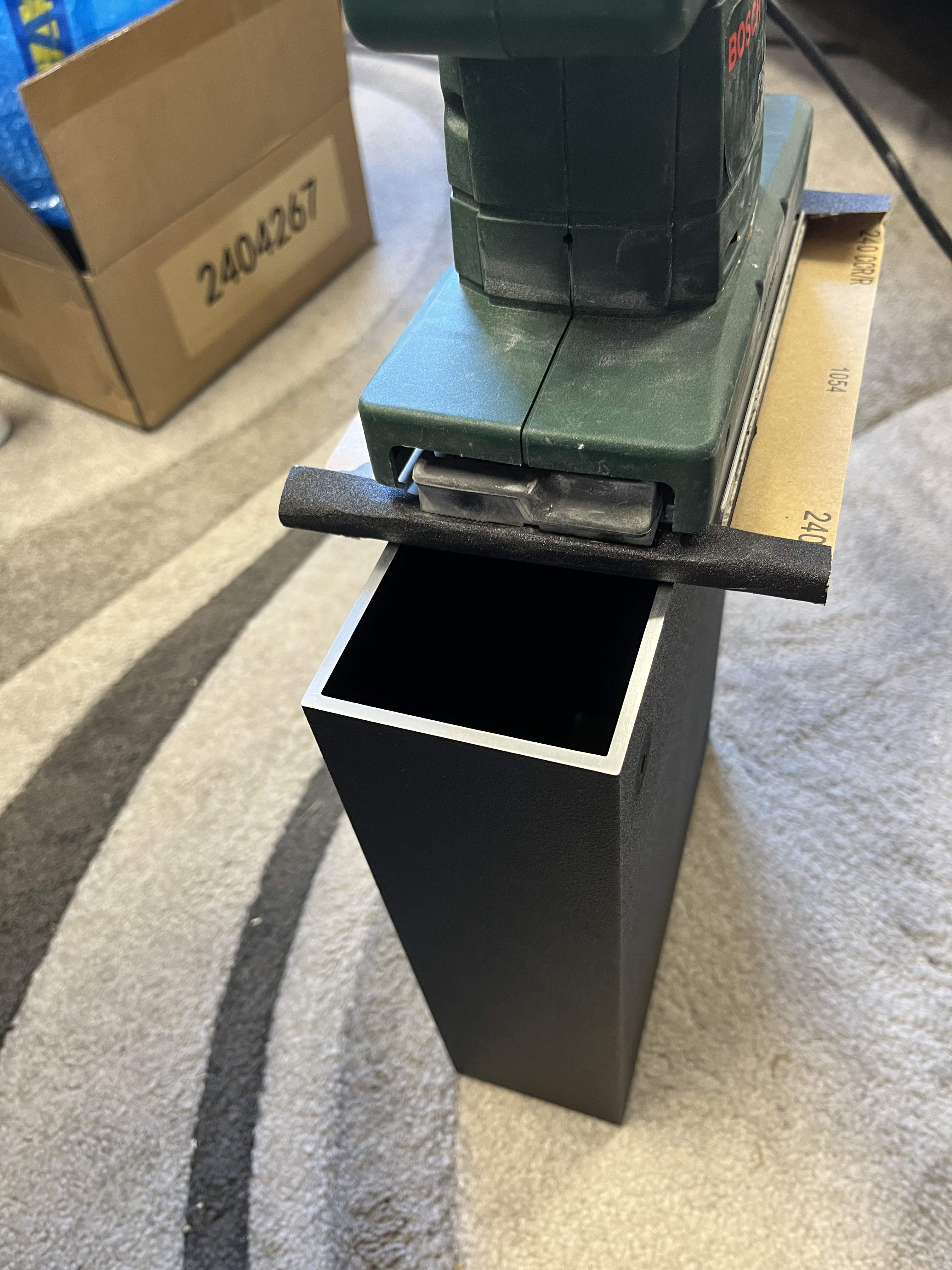

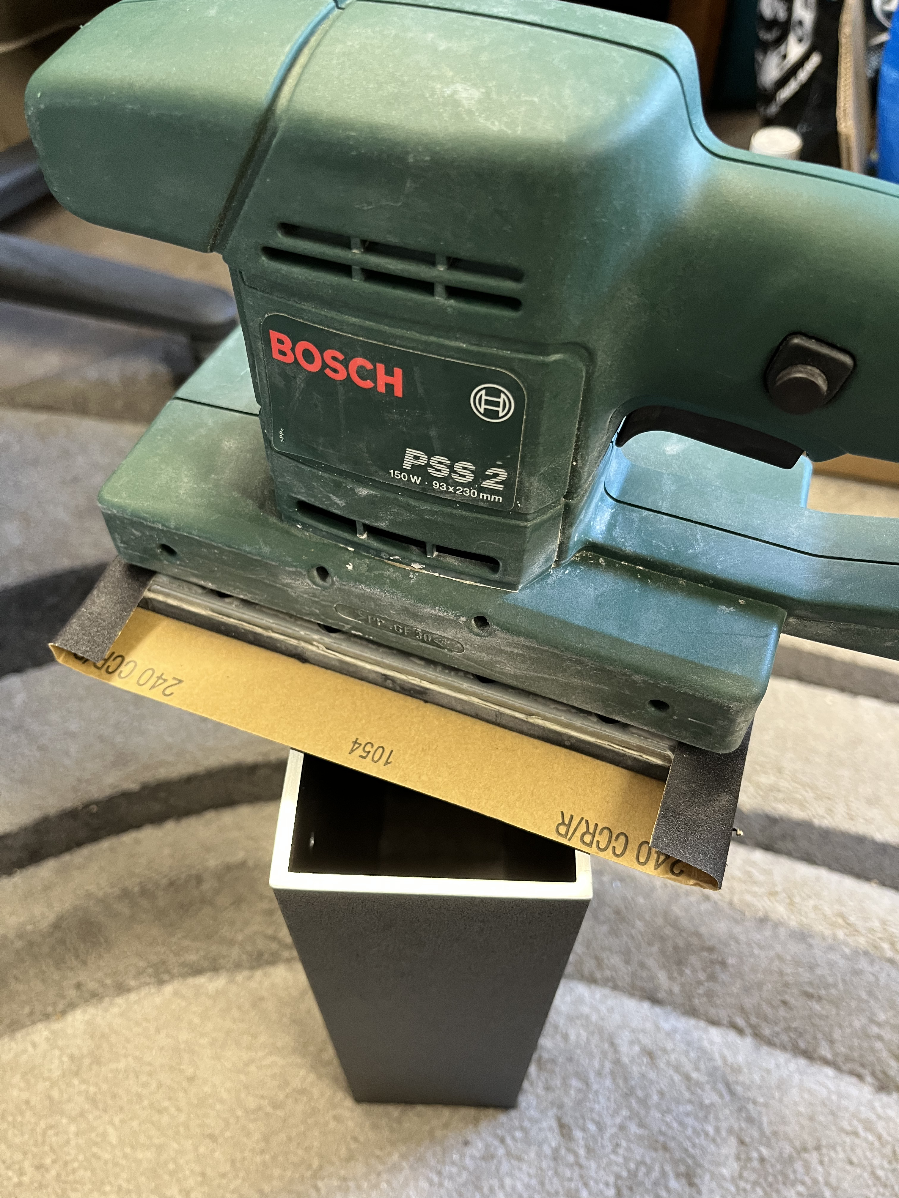

It turns out a 1/3 sheet sander fits nicely across the front edge and combined with an oversize sheet you reduce the risk of damage if the sander “falls off” the edges. The paper is 240 grade silicone carbide, also known as wet & dry.
You don’t need much pressure to remove any tarnish but for scratches or dents, turn the sander 90 degrees and apply some force as well as covering the whole front edge in a sweeping motion.

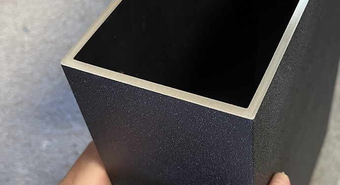

Check progress until you have nice sharp and clean corners

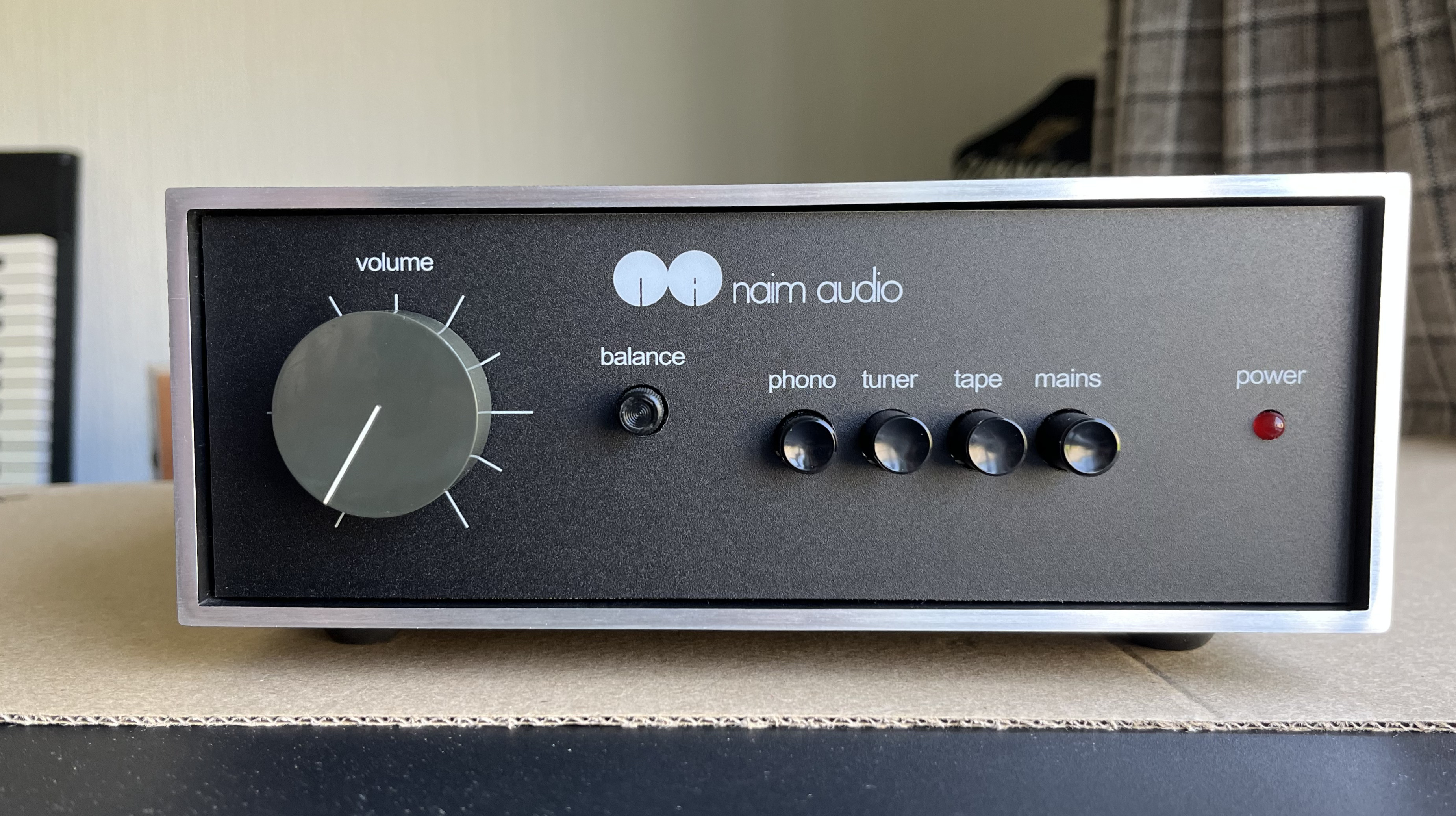

Here’s a NAIT I’ve done previously so no before photo (it did look pretty dull)
