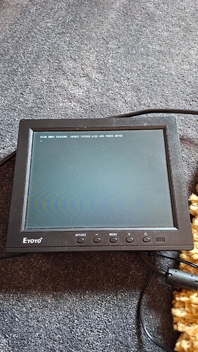

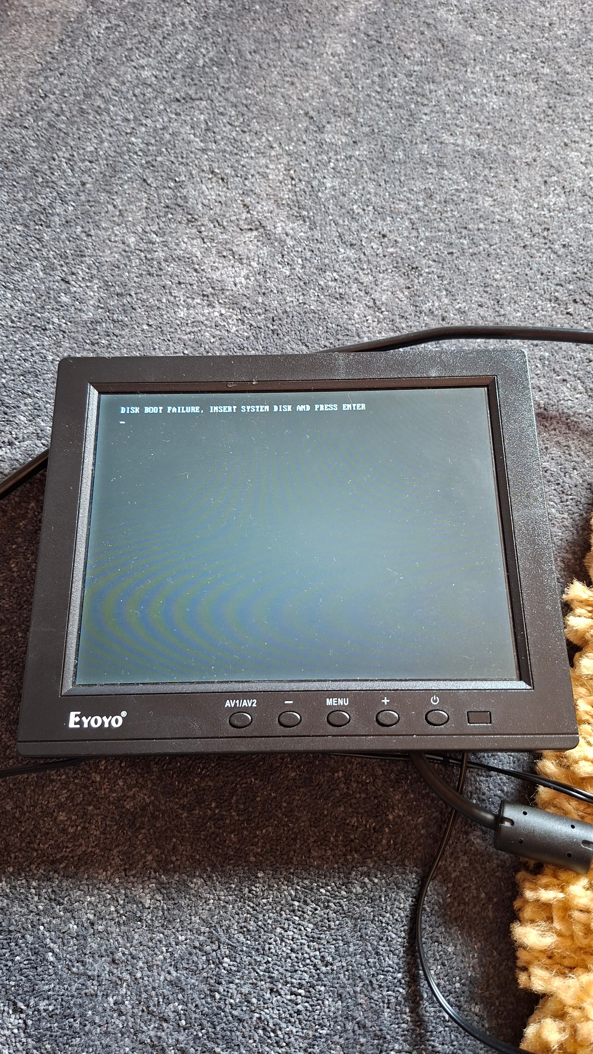

Well bought my cmos battery , Got myself the correct keyboard. Followed instructions ,then get message insert disc …damn after furiously searching everywhere , no sign …
Does anyone have the reboot disc for nso1 hdx…

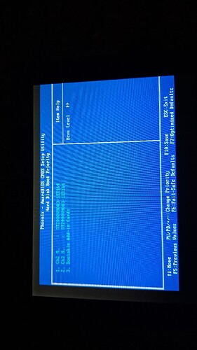

Found these in the process.

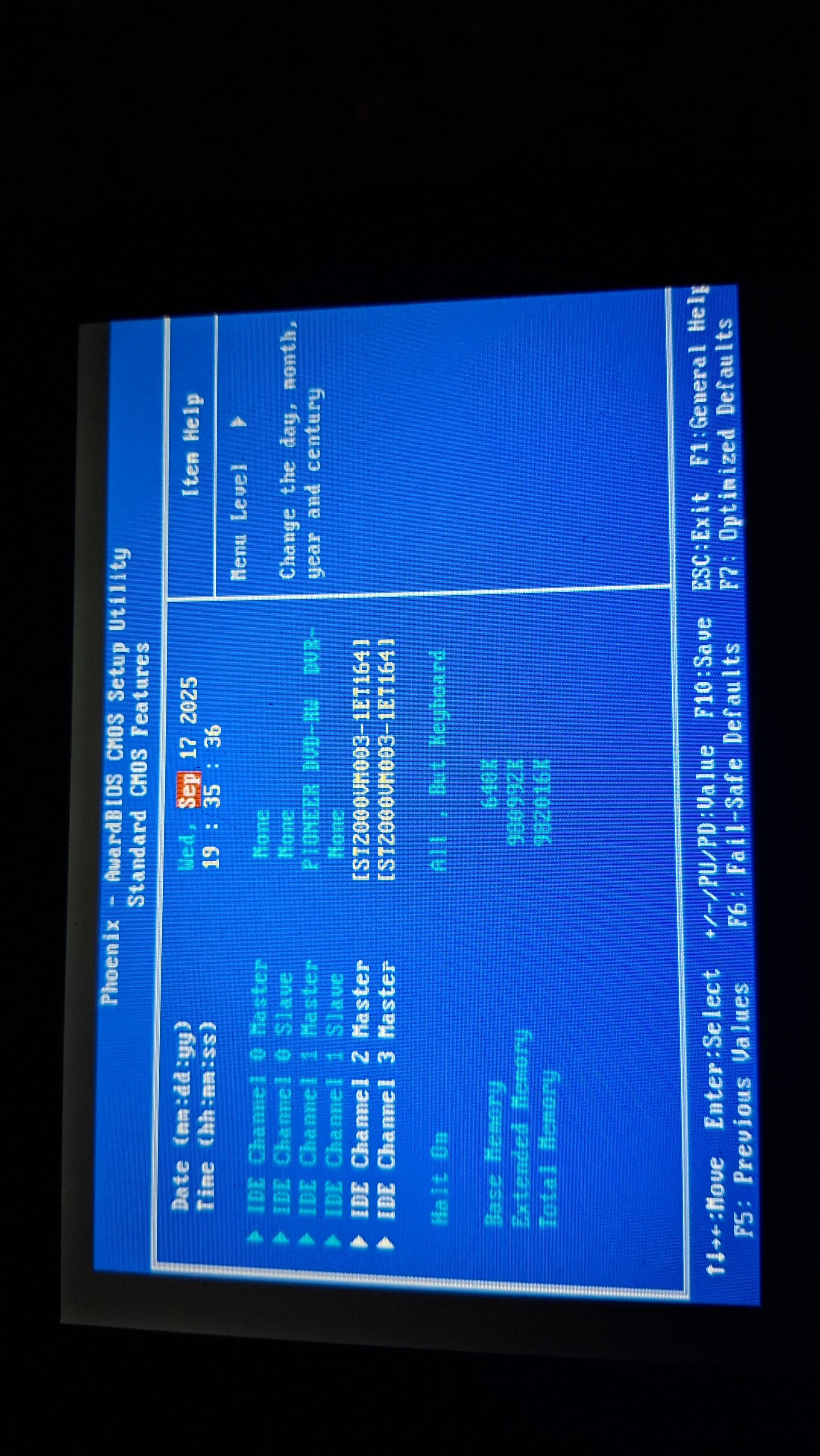

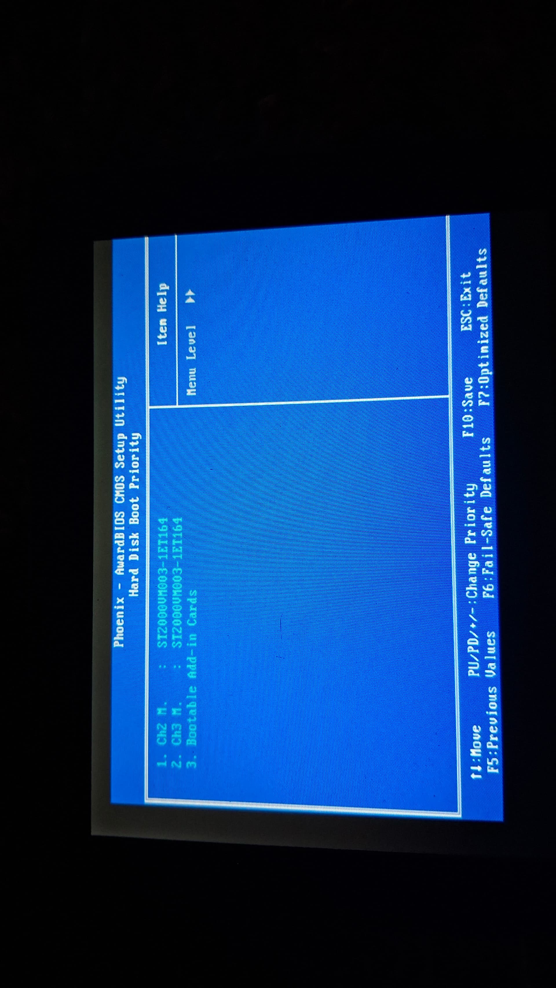

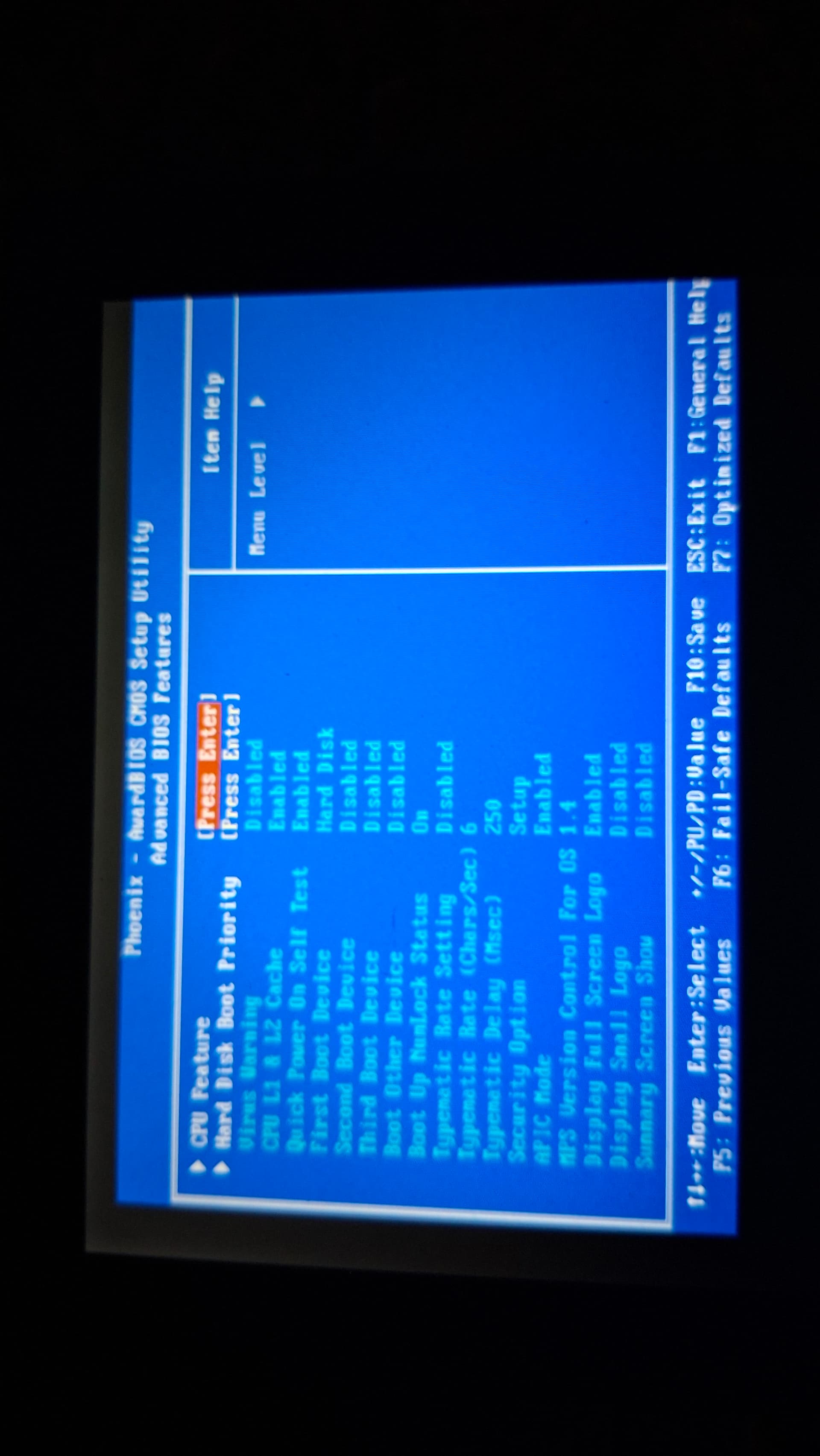

Insert disk means that the boot sequence in the BIOS is wrong and that it doesn’t contain in the list the actual hard drive. So you should be able to correct the boot order so it starts with the internal hard drive.
Of course if it set to the internal drive, it’s always possible that the disk died. Hard drives nearly always fail on power on.

There is no disc to insert, so you can stop looking for it!
You have to interrupt the startup process to access the BIOS. I can’t remember what key you press as it starts up but it should say on the screen. Something like “Press delete key to interrupt normal startup”. Once it’s asking for a disc, it’s too late.

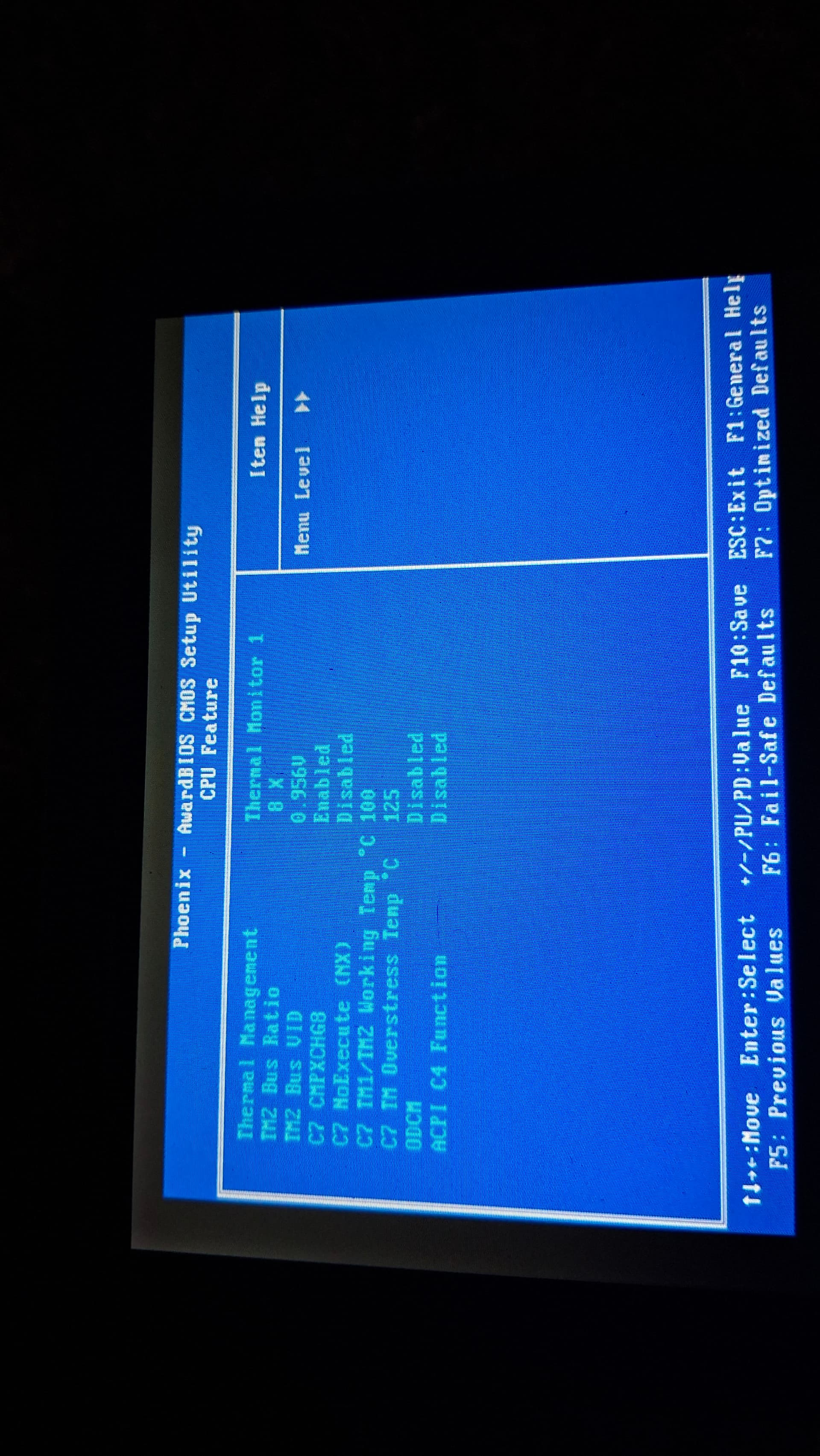

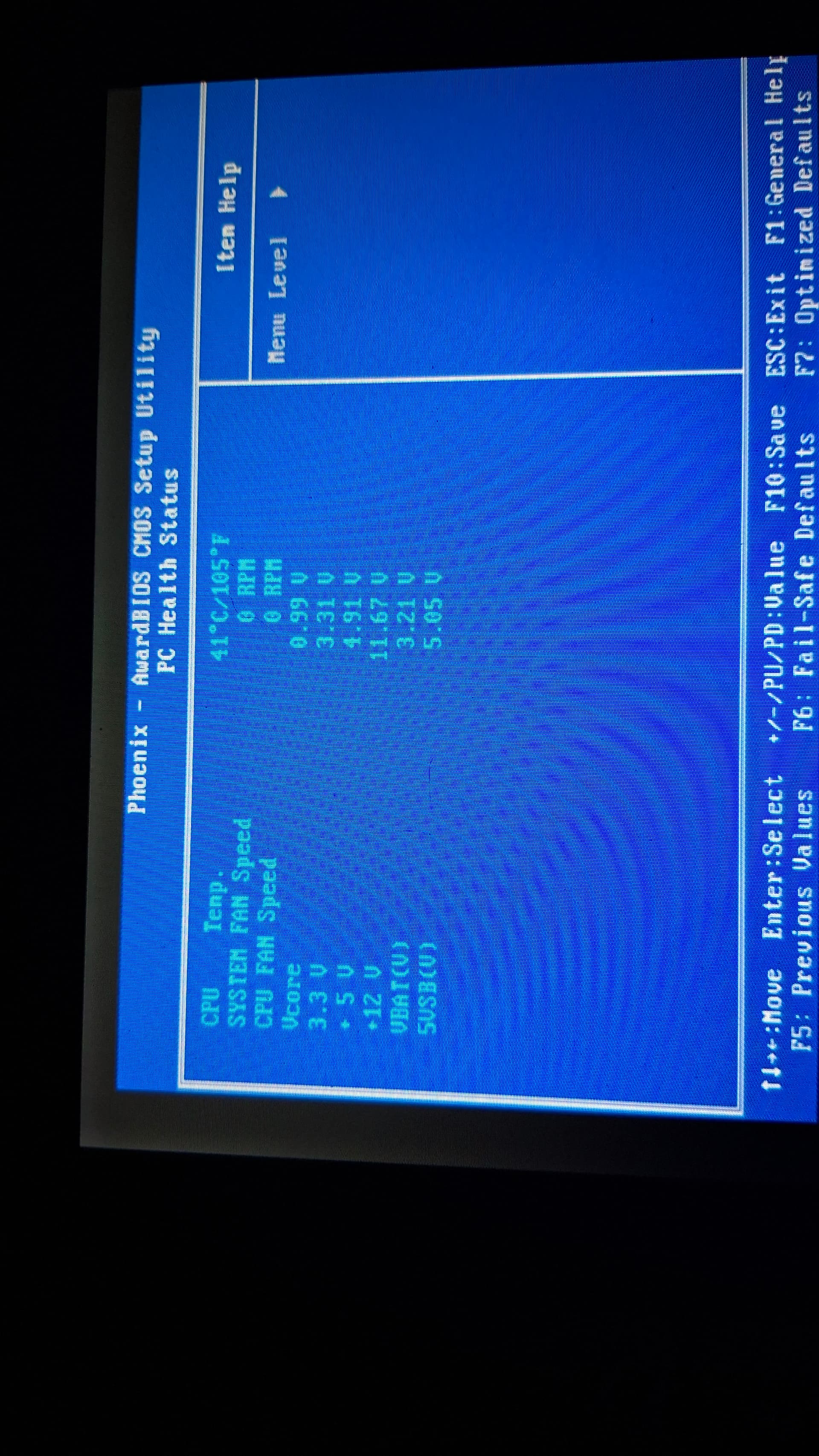

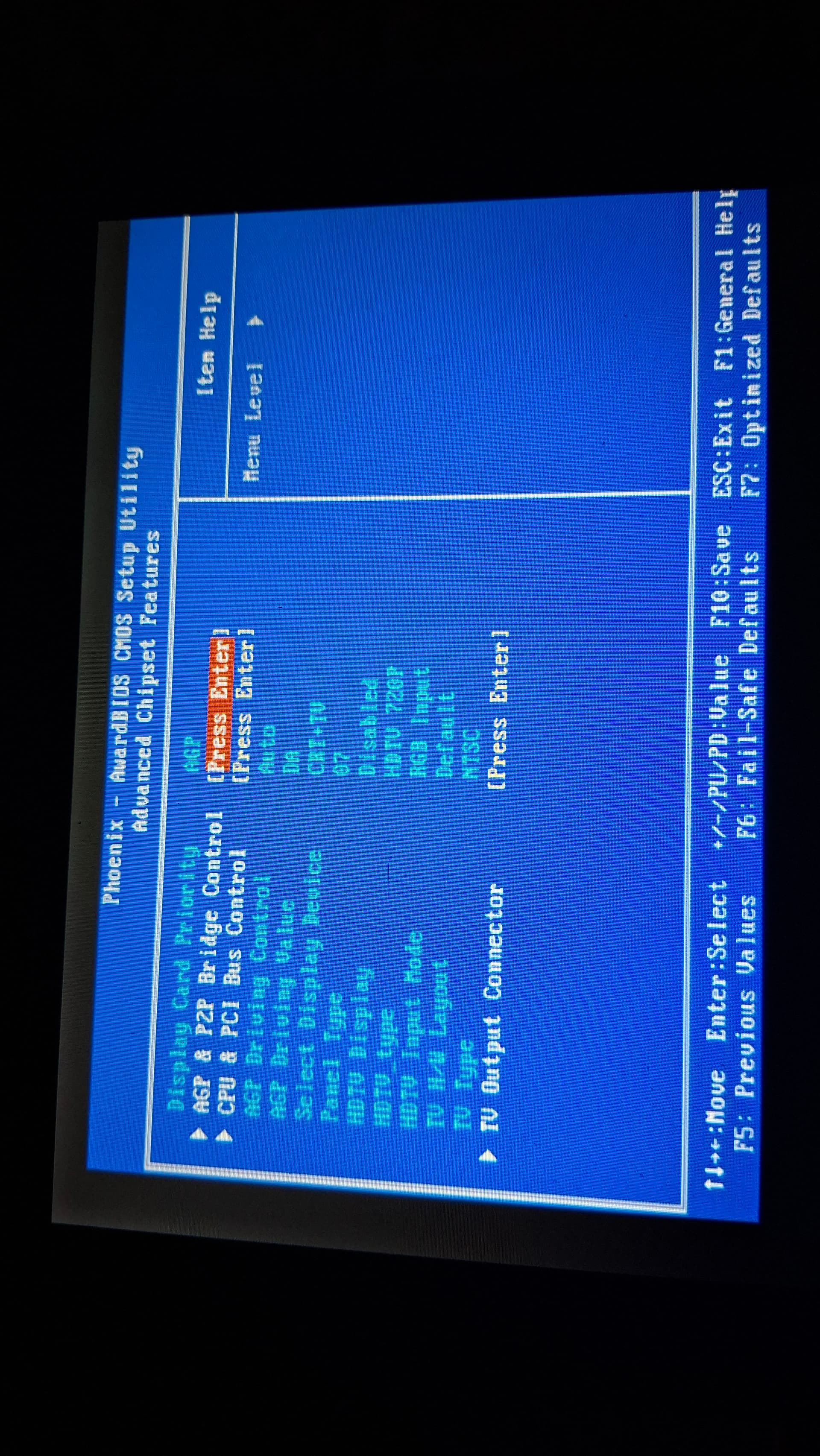

Beyond me

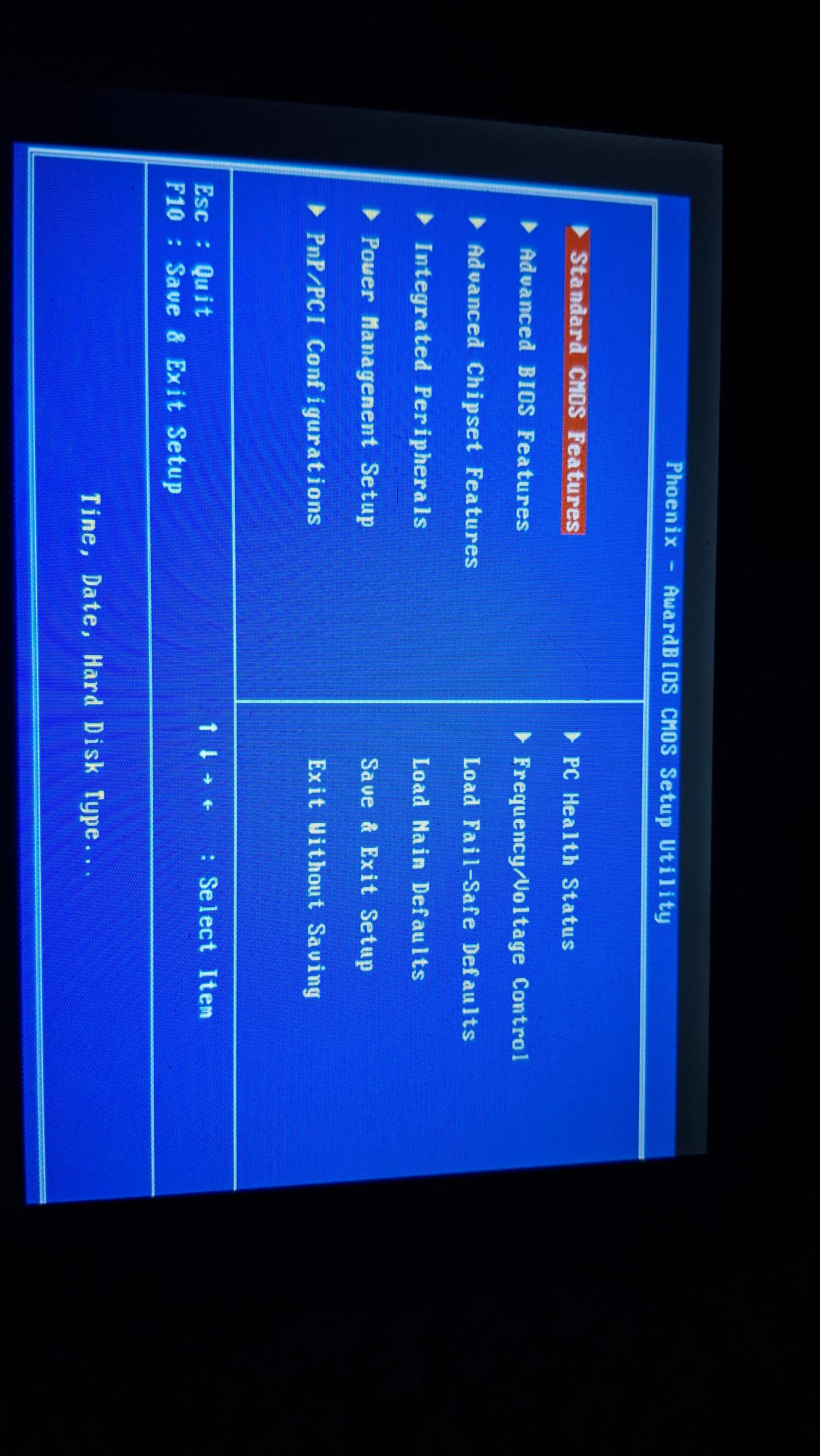

On the first screen you show, choose “Load Naim defaults”. Then save and exit.
