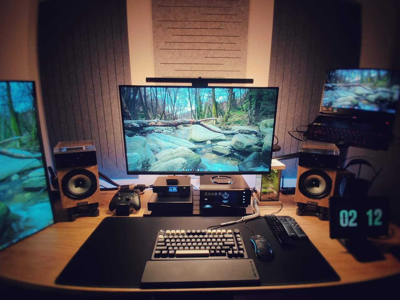

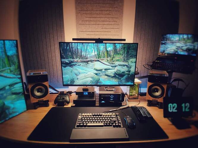

Nice little set up there.

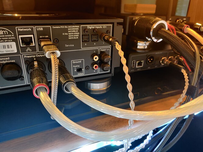

NTraxMartin, could you post an image of the back showing the cable configuration?
Tried my best to reach. Is kinda easy,
PC USB out to Iris USB in, Iris Digital Out Coax to Coax Digital In Atom.
Thank you for a speedy response very nice setup there. I also see a USB input into the àtom, I’m guessing it’s from a storage device?
I’m actually now considering Audiopilleo MkIí as it’s a much simpler setup and I won’t be using the I2 and or AES.
Regards
Thanks, yup that’s a storage device. For Some flacs and DSDs.
