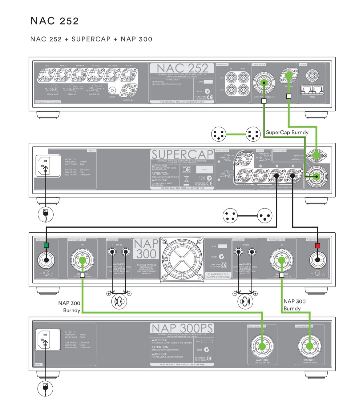

Just to add to @ChrisSU excellent post most Naim pre-amps need an external power supply and the installation is to connect the pre-amp to the power supply using a cable supplied with the power supply and connect the power supply to the power amp using the din to XLR cables you already have. The most common Old Classic preamps are:
  • The 202 or 282 which can be powered by a Flatcap or (preferably) a Hi-cap or a Supercap.
  • The 252 which requires a Supercap.
  • The 552 which comes with it’s own dedicated powersupply
  • The 272 which includes a first generation streamer and its own power supply, so the 300 can be connected directly to it using the DIN to XLR cables you have.
You can get a complete illustration of all options from the Connections Guide which can be downloaded from
https://media.focal-naim.com/naim/file_manager_files/pages/assistance/pdf-faq/connection-guide.pdf
but the number of combinations is high.
