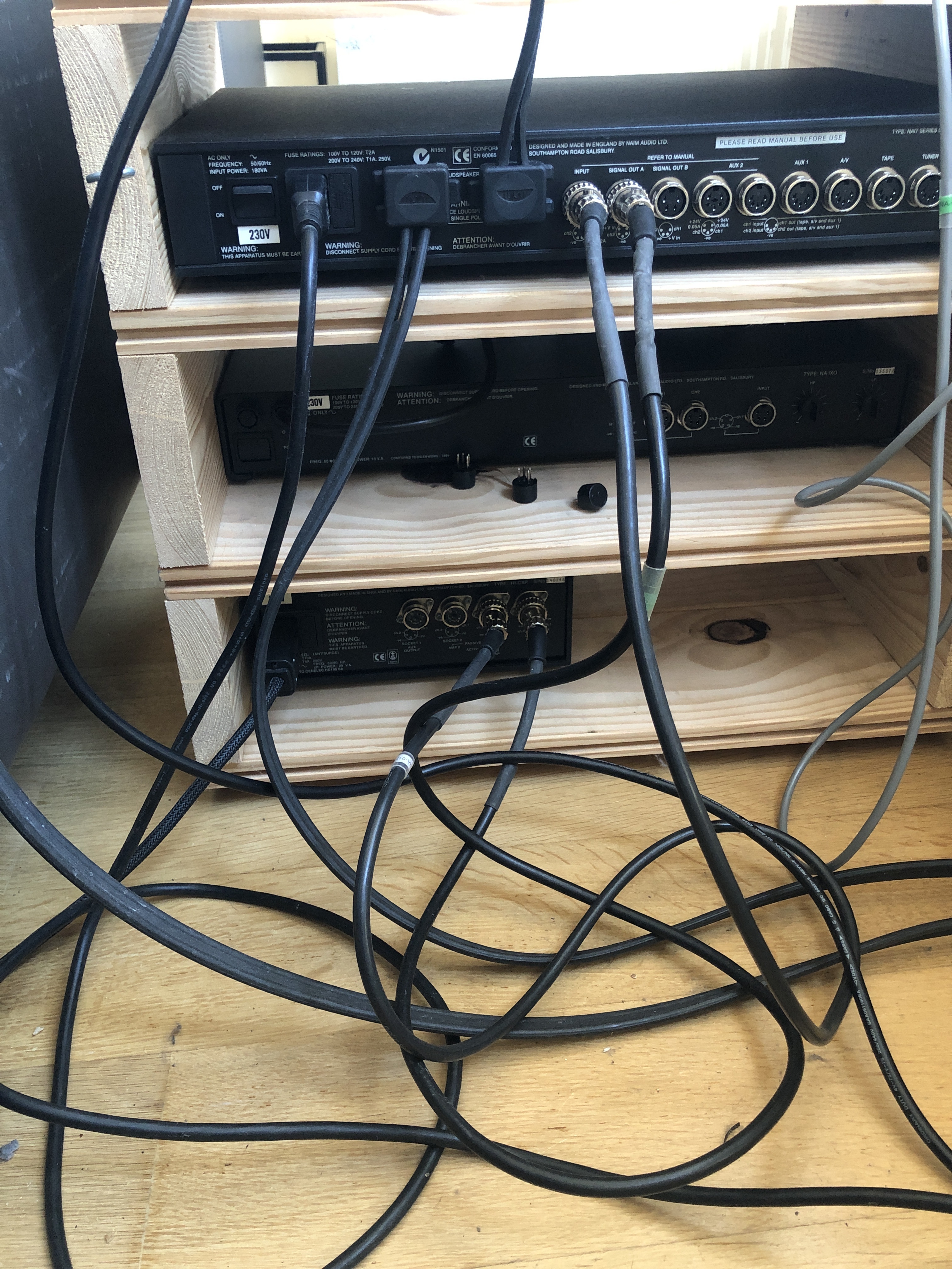

I have searched far and wide but can’t figure this out. Does anyone know how I connect a Hi-Cap to my old (recently re-capped) Nait 5?
Directionality of my cables might be wrong. I did not take care of that.
For this who wonder, the loudspeakers are in phase.

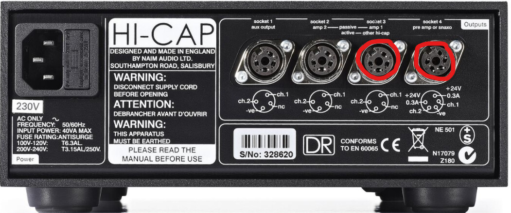

Thanks for the photo!
I did look at the manual but the back of the Hi-Cap does not to my eyes resemble the back of the Flatcap 2.
On the hicap, you would use sockets 3 and 4, and a snaic 4 and 5. You can’t mix up which snaic to use due to the number of pins.
Thank you Robert! I have it all set up now. Beautiful.
