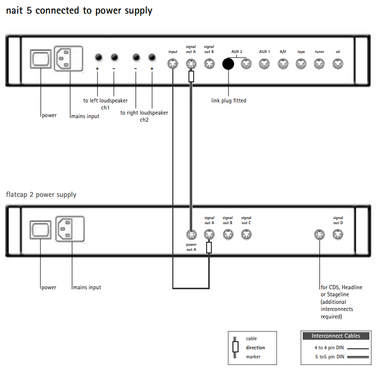

It’s in the manual, see page 7
  1. to add a separate power supply to the preamp section:
    Switch off at mains
    Refer to diagram on page 7
    Remove all the link plugs
    Connect SNAIC 5 between nait and power supply and SNAIC
    4 between power supply and nait as shown in the diagram
    Switch on power supply and amplifier.
