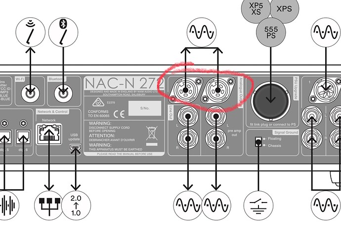

If so the RCA output sockets may simply be turned off! (Check in the setting menu.)
Hi X, I’m currently using an Integrated amplifier and the 272 as a source. The Krell is working fine and I’ve tried different sources to verify that. Could that still be RCA sockets turned off? Is that in the setup menu?
Oh and it was working oh so briefly yesterday on iradio and via Jriver. Now it goes through the motions but no sound…
Xanthe, I think I love you. As part of my trials and tribulations yesterday I did a factory setup so that must have turned the AO’s off. Many thanks, Mike

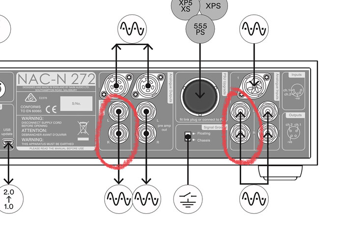

Hi again, how would I connect my Nakamichi tape deck to the 272? Sorry but I’m used to ‘tape in’ and ‘tape out’ amplifier connectors. Rather than trial and error I’d appreciate a bit of guidance. Many thanks once again.
The NAC-N 272 also has line in and out connections, they are just labelled differently. I’ve never tried it myself, but the connections marked below should work for you.
Make sure you use the ‘line out’ instead of the ‘pre amp out’ because the latter is controlled by the volume knob.
Thanks K10, that makes sense.
Also, I’m contemplating a Naim Nap 250 DR to partner the 272. It seems to come with a DIN lead to link them together. Does it only need that? I’m assuming it does as I can’t see any other connectors on the power amp except for speakers.
Lastly, there is a warning not to use 4mm plugs but I only have Kimber Monocle X with bananas. Would I not be able to use this cable?
Sorry if the questions seem basic but I’m only just embarking on my Naim journey…
No worries, the NAP 250 DR is indeed supplied with its own interconnect to connect it to a Naim preamp, because one can also use the NAC-N 272 with a NAP300 DR, there are two identical DIN outputs. No other connections needed …
