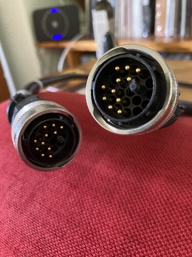

When you power your NDX2 with an external power supply, remove the power cord from the NDX2 and use it to power the 555PS. Then, remove the link plug from your NDX2 and use that port to connect to the 555PS, using the Burndy cable. Can you post a picture with the cable’s connectors (the pin out), se we can be sure you’re using the correct cable?

I would strongly advise contacting Naim support before experimenting further. You say you used the burndy that came with the 555 PS but it doesn’t come with one as standard. (If you bought the 555 PS from a dealer for use with the NDX2 then they will have supplied the correct burndy but may have charged for it.) Burndys for the 555 PS are acquired depending on use. For example neither of the burndys I was using to connect the 555 PS to my CD 555 were suitable for connecting the PS to an NDX2. The correct burndy is the S-XPS and it should be labelled as such.

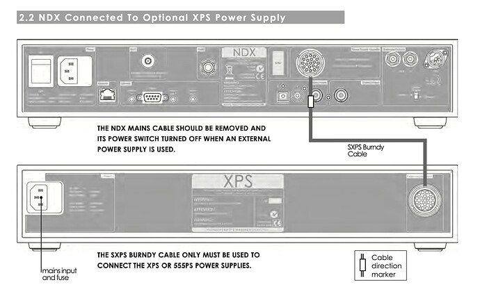

Clive, I agree. The lack of a proper manual for the NDX2 has been a long-term gripe from many here. The old NDX manual was much better and of course illustrates the PS connection and makes clear that the S-XPS should be used for the 555PS;

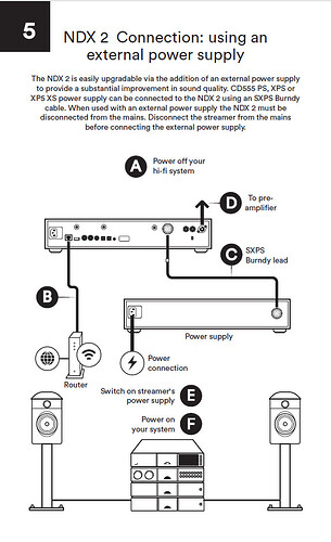

It pains me to ‘defend’ Naim’s Quick Start Guide (*) for the NDX2.
But - it does cover the connection of an external PS quite well, IMO.
- Use an S-XPS Burndy
- Disconnect NDX2 from Mains
- Disconnect the streamer before connecting the external PS

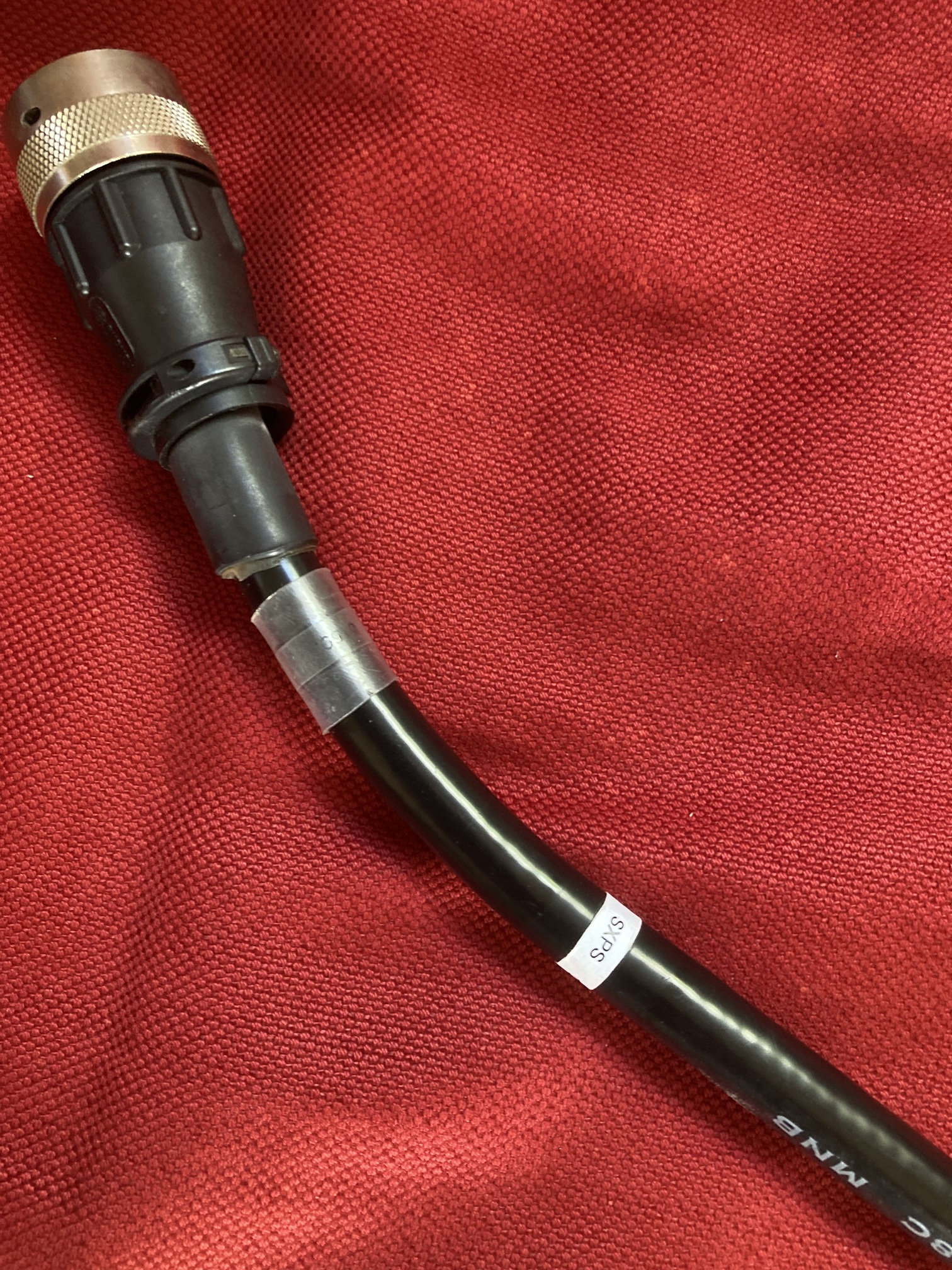

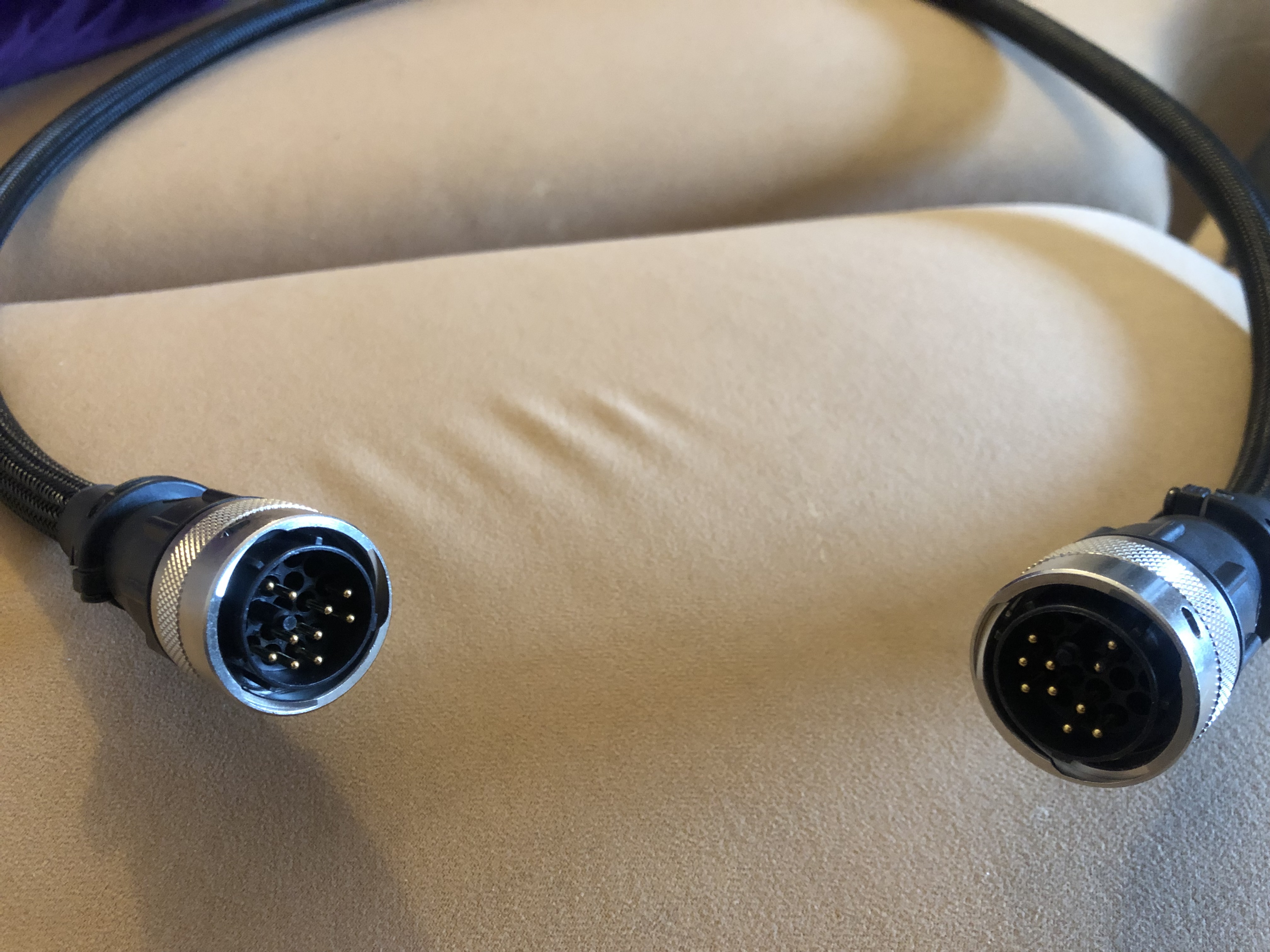

That’s not the correct Burndy. You need an S-XPS version, which has a hard plastic sheath, rather than the braid. Hopefully getting the right Burndy will fix things, which you won’t know until you try one.
