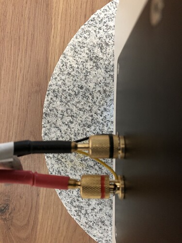

@johnt yeah, the BK is definitely larger. My GF would kill me…haha. Could you show me a picture how your described setup looks on the back of the speakers please? I can’t imagine any other non-soldered solution other than stacked bananas.

This the back of my Iota Alphas, undo the nuts on the binding post wrap the wires around the post or use spade connectors, tighten the nut up and plug the banana plugs back in. The Neutrik lead has 3 conductors which normally connect at the back of the amp, but but Naim prefer the connection at the speakers so when connecting to the back of the speakers 2 conductors goto one speaker and the third goes to the other speaker and then everything goes back to the sub. A normal Neutrik cable has all three conductors bundled together, so you will need one with either an extension cable from the red conductor to the other speaker or the red conductor stripped out back to the plug so that you can route the rec to the other speaker. The BK has continually adjustable phase whereas the REL I believe doesn’t. The best sound I have found is with the Hi Level connection. It will take you a considerable amount of time with lots of tweaking to get the room position of the sub, volume level, crossover point and phase correct, don’t be tempted to over do the crossover and volume or you will end up with a bloated sound and wish you had never got a subwoofer. Maybe use REW and a umik-1 mic to help get everything correct.

@johnt Great! Thanks a lot for the picture and the explanation.

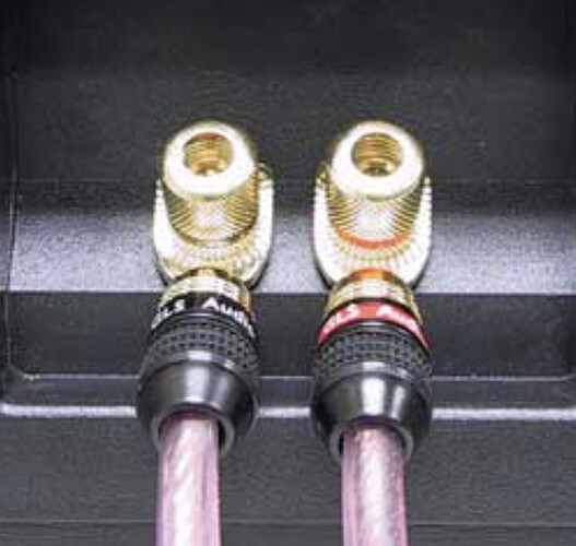

There will be a threaded section that will unscrew to allow you to slide the spade in and then tighten it. Like this:
The banana should still fit in the end. This is probably the best option as you can keep the plugs on your TQ cables, and they still fit into the sockets as they do now. It worked well for me, but I don’t have Neat speakers, so I’m not sure what the sockets are like.
I would have thought the Neat Iota speakers have the same connections as the Neat Iota Alphas shown in my picture, if it does then the picture shows how the connection is made. The BK BK P12-300SB-DF Subwoofer I have mentioned and use does not have a passive radiator. You can pick a cable up from the bay, they are non manufacturer dependant and are relatively cheap.
