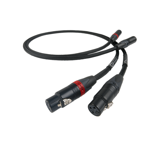

Good morning everyone. But if you wanted to use a non-naim cable to connect the 332 to the 300, would that be possible? Would a pair of regular XLRs be fine? I read about a user who used a pair of Chord signatureX arays to make this connection. Those are normal xlr cables…
No - I believe the NAP300 and 500 use non standard XLR cables; wired differently.
I’m sure Chord would make a pair up for you - at a price…
one user used these. I’m pretty sure why we talked about it.
The NAP300 XLRs are single ended, not balanced, also the XLR ends are handed and wired differently for each channel. Off the peg cables will not work here.
Thanks Richard :pray:
