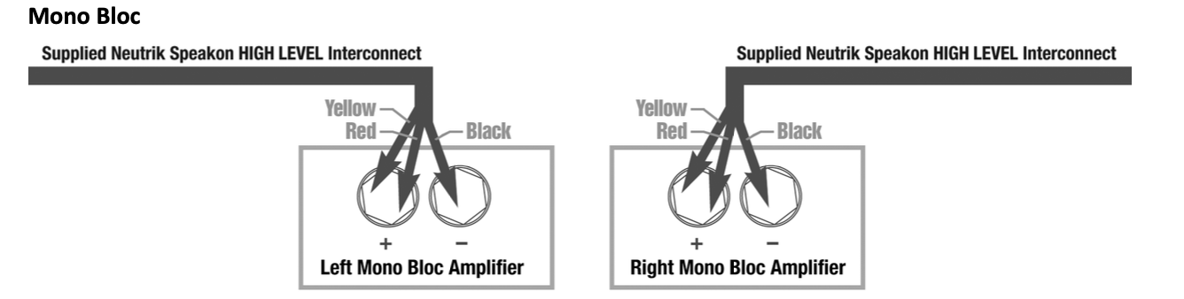

It’s a bit confusing. In the face of it, what you wrote seems wrong. The red and yellow are the positives, and the black is the negative. If you connect both positives to one speaker, you’ll only get bass from that speaker. Connection should be exactly the same at the speaker end as the amp end ie yellow and black to left and red to right - or yellow to left and red and black to right, it doesn’t really matter. The key thing is that yellow and red must go to different channels on either amp or speaker, otherwise you’ll get bass from just one channel.
This is exactly what I am referring to. You only combine red and yellow when connecting stereo pairs, one complete sub per channel. I used a single sub for many years. Both channels got one or the other of the red/yellow and one channel got the black.
The only time you combine red/yellow on one post and black on another with a single sub is for a center channel sub.
This is what the manual shows for connecting a single sub to two channels. Whether you do it at the amp terminals or speaker terminals is inconsequential.
If you are using mono-bloc amps, REL says two subs must be used and the connection looks like this, which is also how I connect my two subs (except I use the terminals on my speakers). This is when you combine red/yellow.
