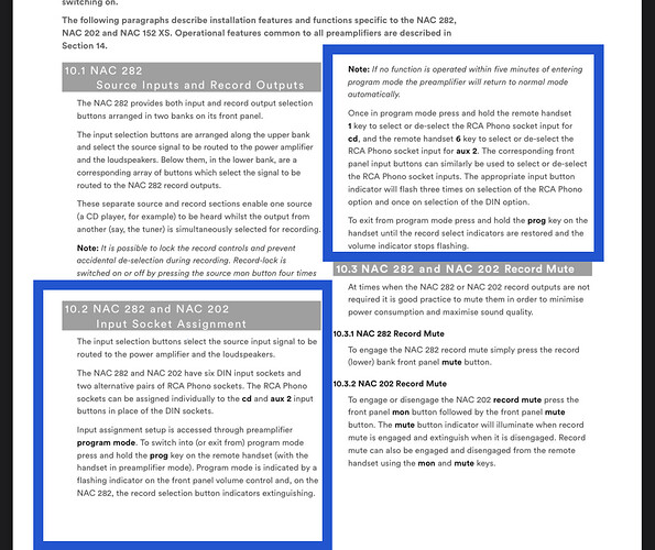

In the app, you select the NDX2, then output settings, and select RCA. Follow the manual instructions for the 282 and remember to exit program mode. I’ve tried RCA when the relay failed on the NDX2 DIN output. I found the DIN output on the NDX2 to be quite significantly better over RCA.

Excellent. Now for your next challenge - selecting the phono input on your 282. This is how it’s done…
