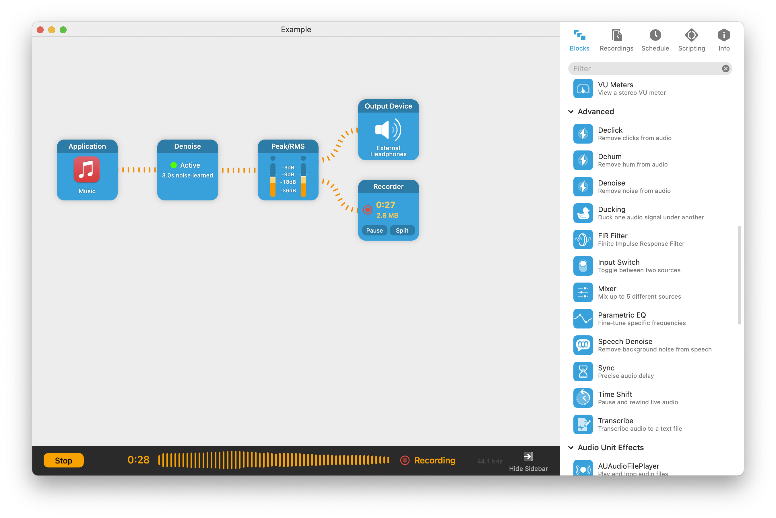

Have a look at Audio Hijack by Rogue Amoeba
On my first pass at this, I saw a lot of ‘boxes’ with RCA inputs and RCA outputs. That alone doesn’t help as I think the new MBAs only have a headphone out - no audio in

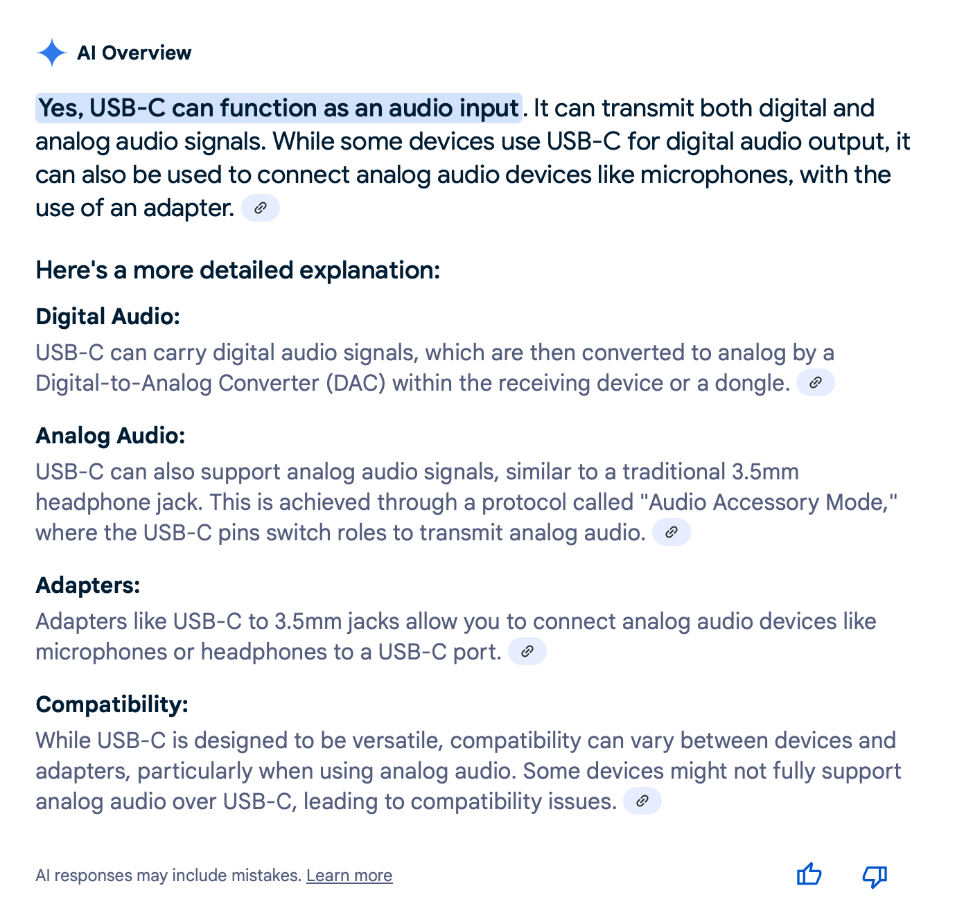

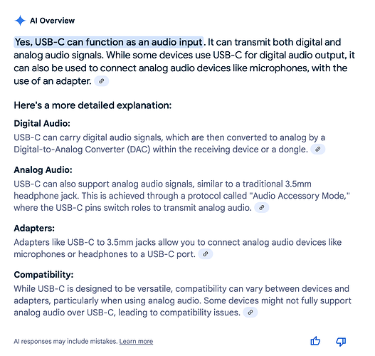

USB-C can support analogue audio signals, similar to a 3.5mm headphone jack. I had no idea. :thinking:
Ah, that’s interesting - never knew that. Good find.
A quick example of what Audio Hijack can do.
You can give it a go there is a demo version, it just limits the recording to 10 mins.

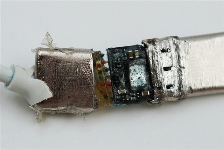

That adapter has a dac in it, believe it or not.
really?? for ten bucks?
Yes. It’s the only way to get a digital audio signal into a 3.5mm headphone socket. The dac is inside the usbc plug end.
“46L06-CWZR Chip from Cirrus Logic, this is a highly integrated chip that includes features such as USB Controller, DAC, and headphone amplifier“
