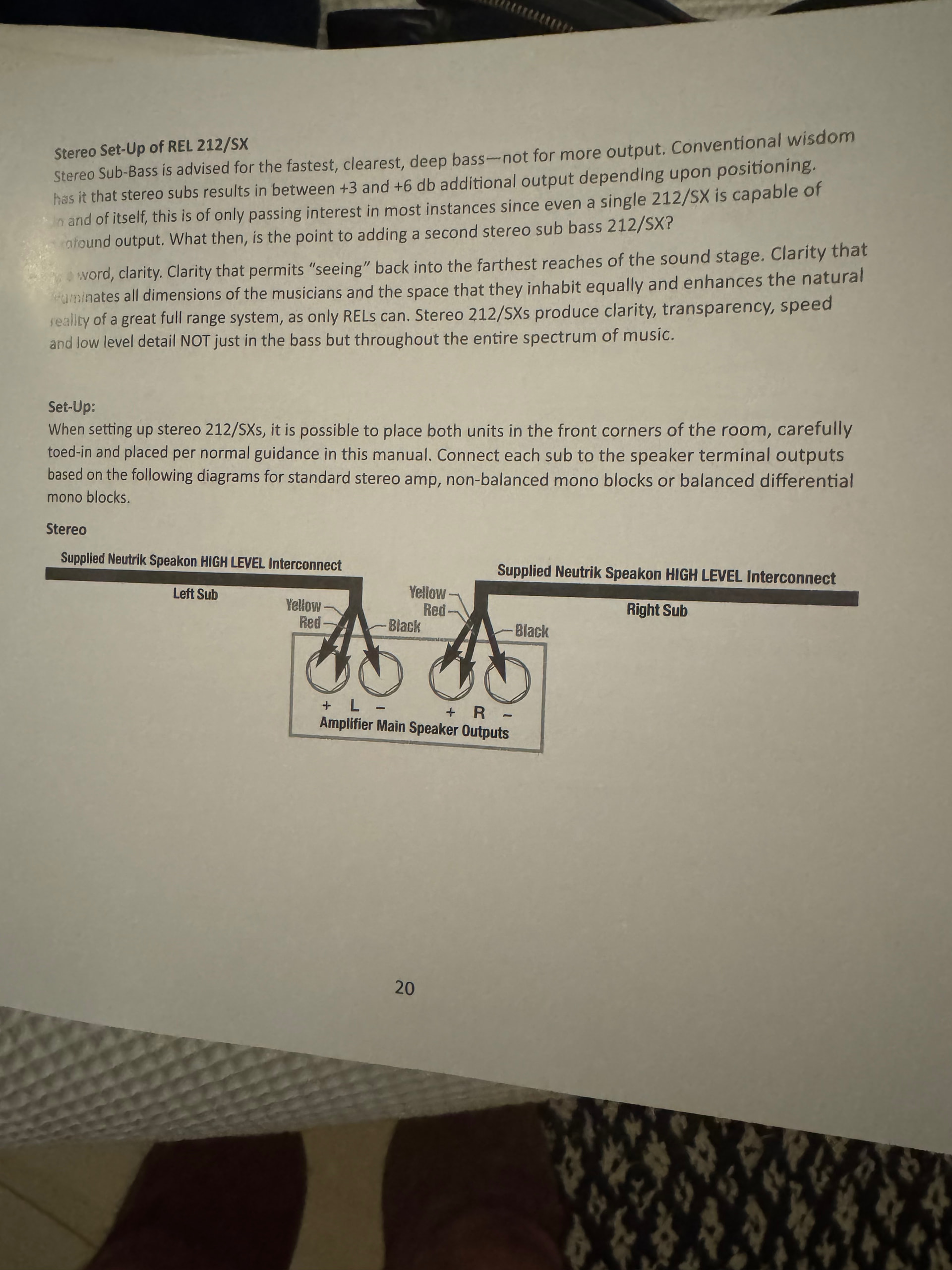

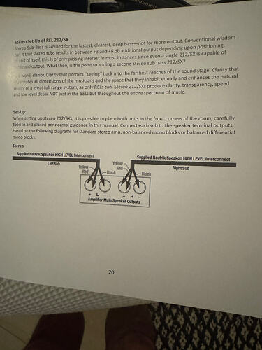

Good morning HungryHalibut. Attached is the relevant section from REL manual for setting up a pair of S212s. They indicate Yellow/Red are combined rather than split between +/- (as is the case for a single subwoofer). I have tried splitting the yellow/red this morning but it doesn’t sound better - I am playing at low volume as it is still ahead of the first cup of tea for the boss :grinning_face:. I will try at higher/normal volumes later in the morning and feedback which I think sounds best.
If using a pair of subs you’d connect as you have. If using one sub, you connect to both channels.
Connected back up as per REL guidance. Sound quality back as it was. Nothing ventured nothing gained :grinning_face:
Ah, so you have two subs. Apologies, I didn’t realise that, or I wouldn’t have suggested moving the plugs.
