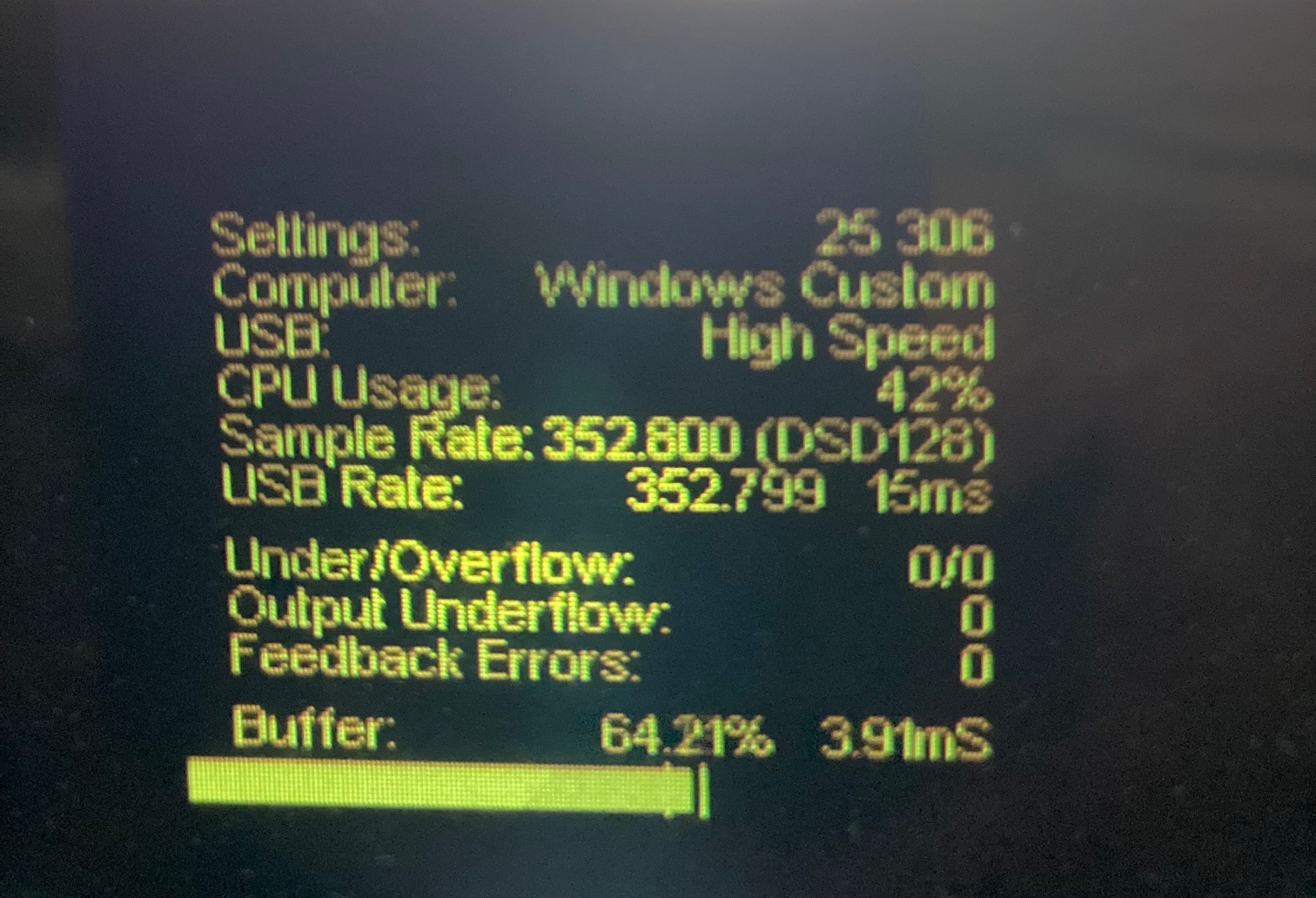

I normally use the DAC-V1 with Linux but I switched it over to an Intel NUC that is running Win11. I do get drop-outs with DSD files but PCM ones seem to play fine.
I will investigate the DSD to DoP issue, but my DAC-V1 display is failing!

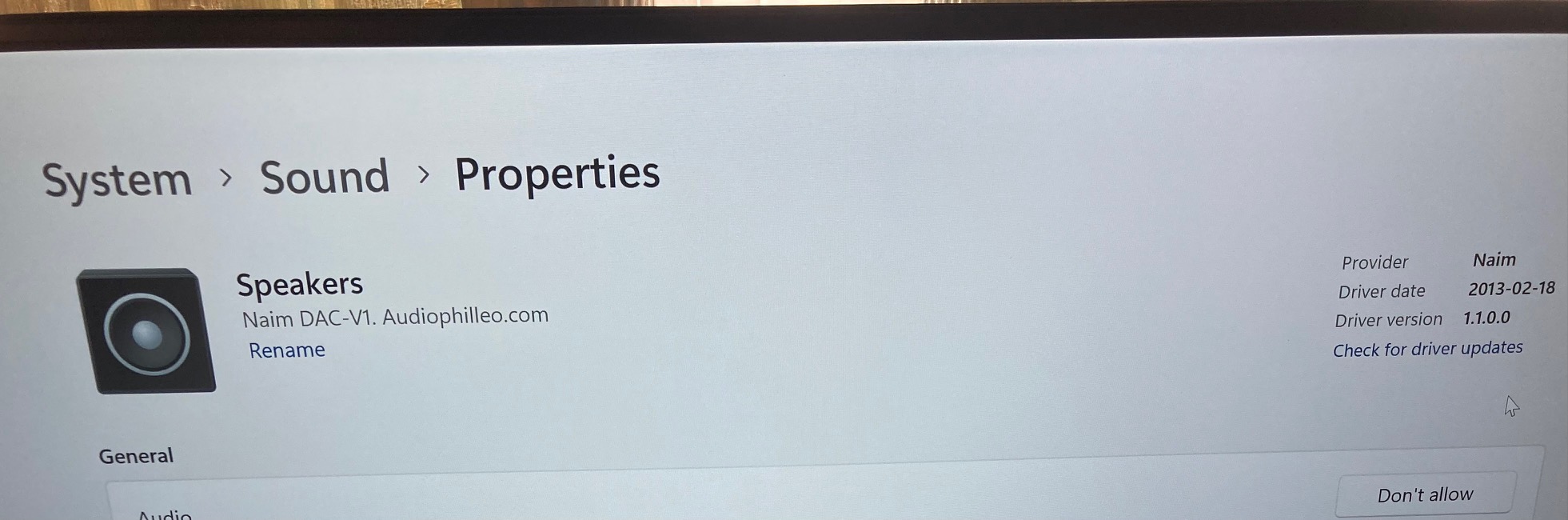

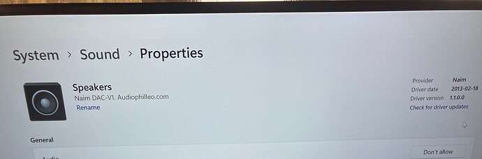

Checking the USB driver being used in WIN 11 for the DAC-V1 showed a generic one. I re-installed the NAIM Win (7/8) driver and it seems to work fine now.

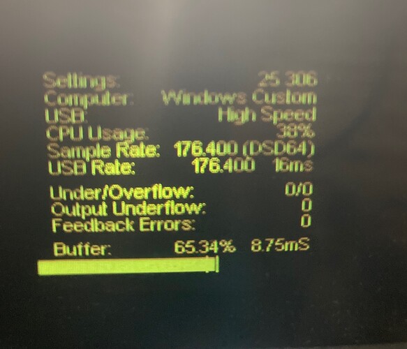

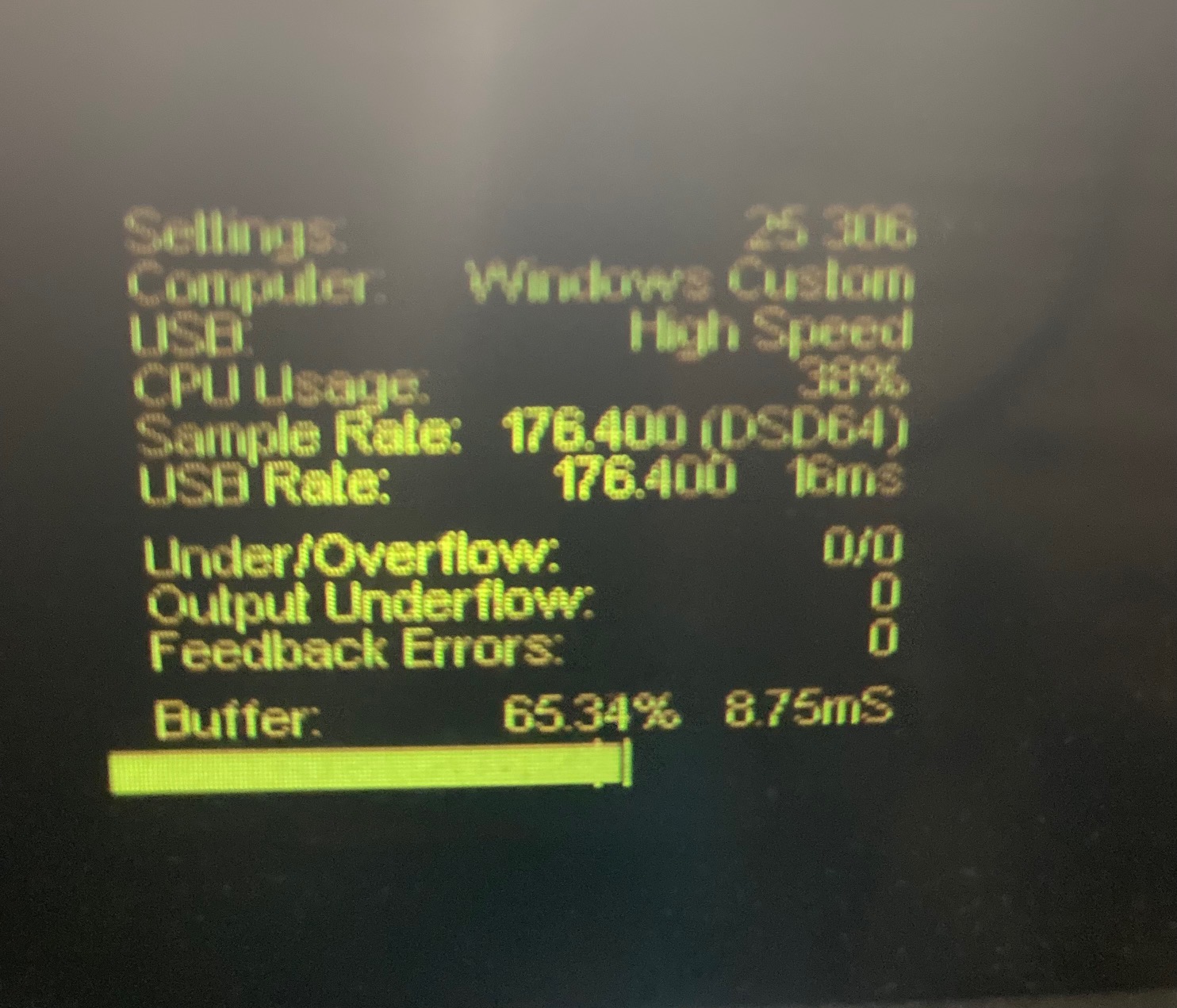

I did check out the drivers and I was using the Naim driver. However I noticed that I was not getting the usual multi-second delay when I stop a track via Gizmo. As the delay was set in the DAC (via its buffer) the implication was that the system is not working in asynchronous USB mode. For a quick and dirty I set a 250microsecond delay in JRiver and that largely cured the issue. So it looks like the problem is buffering and tomorrow I’ll try to get to asynch mode to work.
