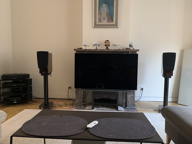

Completely spot on! They are booming like hell and muddying the low frequencies, unless I add a digital filter to reduce the 45Hz frequency. And I bring them over 1 meter into the room which is not really reasonable…
Indeed it’s clear that I will replace them. No point (and no budget :joy:) to improve the front end. The search is on (after 10-day school break :innocent:) to figure out what I want from a speaker that works in my room…
You can try to avoid the final solution, but it’s SBLs what you need here if your wall is solid. I assume it is since this is an older house.
This is what they are made for.
Solid wall indeed it is. But not sure I want to go this way (also looks not approved by OH :sweat_smile: :sweat_smile:). And not that easy to demo them obviously…

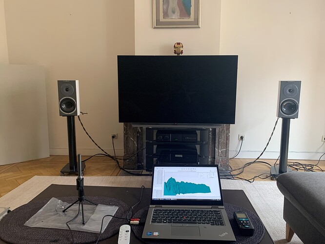

Part 2: Home audition
The kind dealer came home, fine tuned the position of my speaker stands at a reasonable position not too far into the room, adjusted the Isoacoustics GAIA and installed the Audiovectors + REL T7x. The subwoofer was connected via the high level connection to the right speaker only, for avoiding to make a mess of the cable. The result should be indicative enough anyway. On top of that, we connected the speakers via a pair of Chord Epic XL cables. And finally, he suggested to remove the bass traps from the rear walls for improving the reflections of the tweeter (in the Audiovectors, the tweeter is also rear “ported”). I didn’t get any nice pictures, but here is how the setup ended looking like:
Today, when he came back to pack things, he also brought along (after my request) the ND5XS2 to compare as a transport vs the Allo Signature into the nDAC, as well as a pair of ATLAS speaker cables to try out something at a lower price point. So many permutations to try out and easy to get lost… I will summarize my findings below.
Part 3: Evaluations
  1. Bass traps
    Following some REW measurements, I got flatter mid-bass response by having the bass-traps in the corners (I put them on the two left-side corners as the REL was on the right front one). So that stays there for the time being
  2. REL T7x
    The sub was brand new, so it never performed to its full potential, as it needs plenty of running in. Overall I configured it at pretty low gain level to get a positive impact. I tried the room corner, as well as in the middle of the room, in front of the Naims, where I could get a more flat bass response. Towards the end of the week I could get an idea of their positive contribution if set up properly, with a nice “filling-in” of the sound. Didn’t manage to get a perfect set-up, but I can understand their potential.

That doesn’t look like a speaker problem, it looks like a healthy obsession to me :rofl:
But seriously, maybe put a blanket or duvet over the TV.
I still think you’d be best shooting down the room rather than across it as it would get you further away from the speakers.
Also sometimes speakers need a long time to burn/settle in, if these demo units are new then maybe they haven’t had enough time.
One last thing, if you’re using a Lavender source cable then maybe try something else. I’m sure your dealer will lend you some to try.

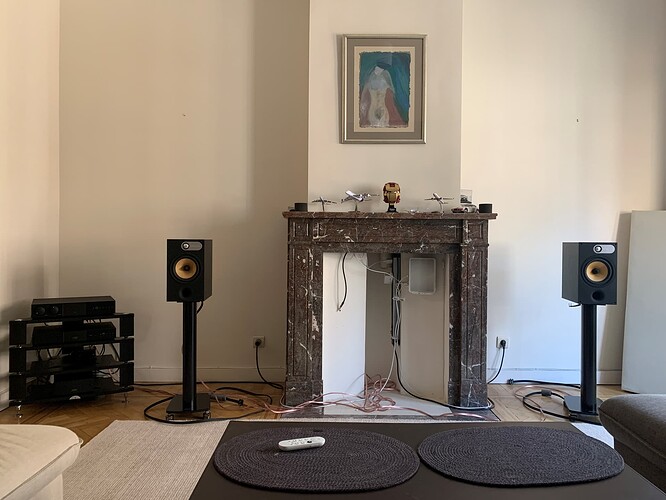

Healthy? That’s very optimistic… :rofl: :rofl:
I’ve tried putting some pillows/blanket in the past, but no real difference. Right now I am doing some experimenting and the TV is out. And that does make a positive difference.
I’ll give it a shot this weekend now that everything is upside down and I have some extra long (amazon) speaker cables to see what I get… Previous attempts with suboptimal positioning didn’t measure that well, but now I should be more flexible.
These speakers are well run-in so no issue there. HiLine interconnect used from nDAC to SN2.
So in the end I didn’t try that out, as the sofa gets in the way for optimum placement and it is not a long term viable solution…
On the other hand, I decided to keep the Naim stack in the corner, as this gives me two benefits:
  1. The TV is now lower and flush with the fireplace, thus moving back ~10cm and allowing a bit more air between the speakers.
  2. I gain an extra empty shelf on the Fraimlite stack for extra separation or future equipment… And of course the stack can get higher… :scream: :sweat_smile:
The main issue now is of course the need for longer speaker cables. I patched up a pair of 7.5m from Amazon (€50 together with some banana plugs), but obviously this solution cannot stay for too long… Any suggestions for a cheap decent cable at 5.5m? Looking at WitchHat N2 cable at the moment which should be cheaper and more convenient than Naca5. Even though the cable choice might depend on the final speaker itself, so possibly no point to change at the moment.
In addition, I am considering to replace the stock power cables of the nDAC and the HiCap with something (much) shorter, but of potentially higher quality, again at a modest cost. Main motivation is to manage the cable mess behind the Naim stack, but any concurrent sound improvements would be welcome. I came across the MCRU No. 75 EU Schuko Power Cord which is available at 0.7m and should do the job. Any suggestions here? The SN2 is on a Powerline which will stay. The extension board is the “Music Line Netzleiste Plus”, so essentially a decent simple block with a Powerline.
