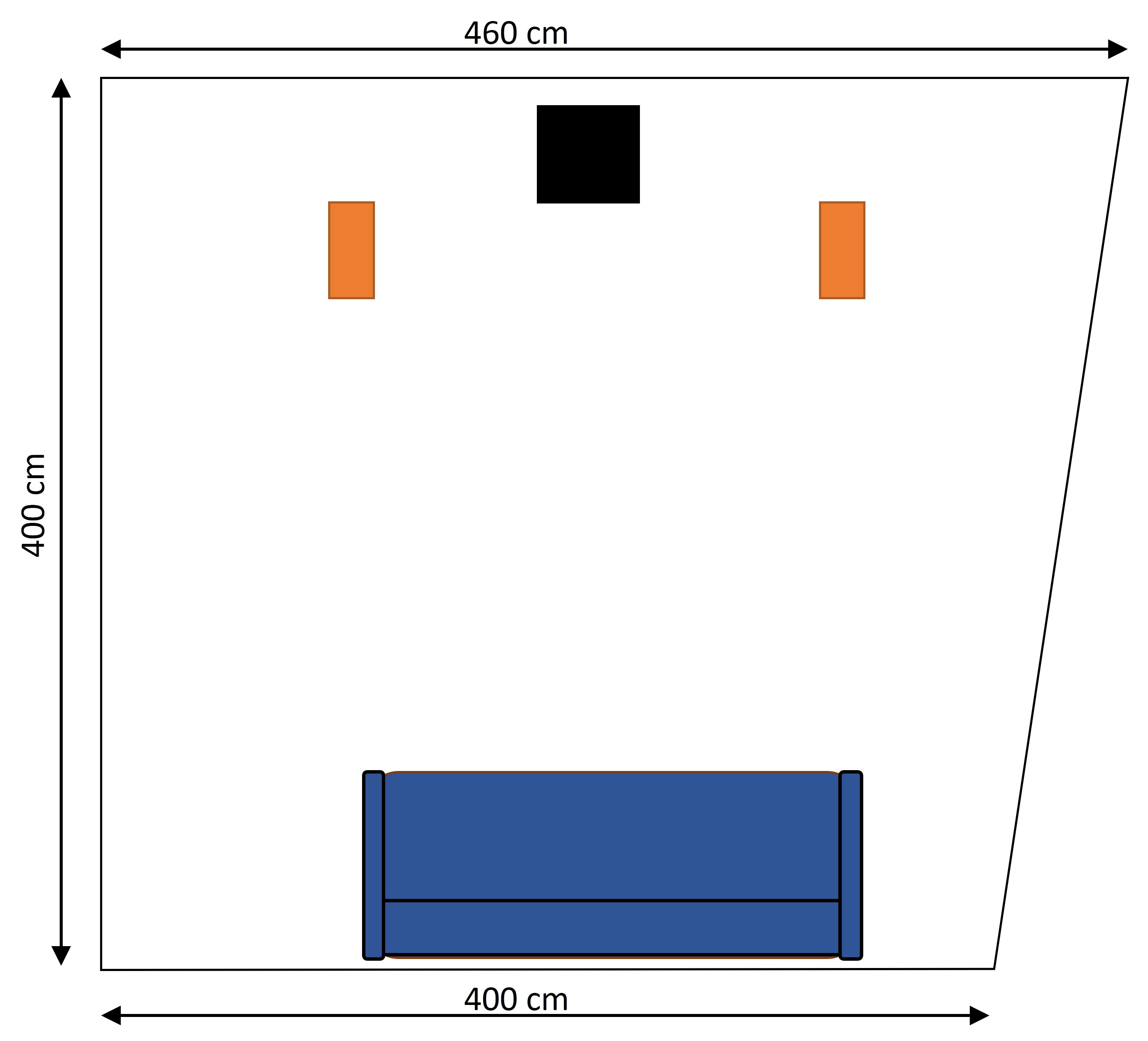

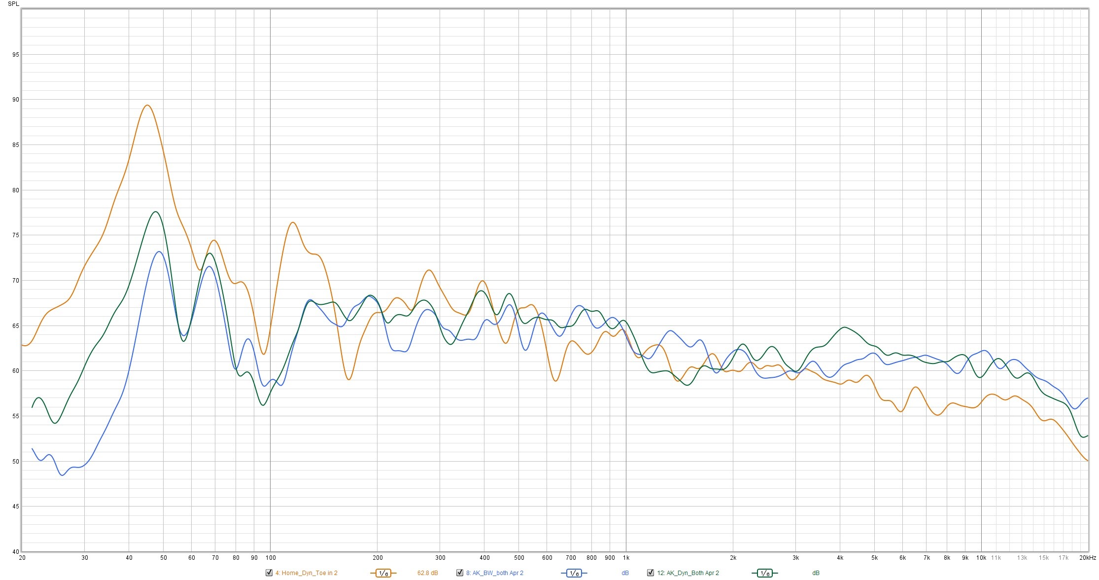

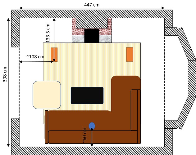

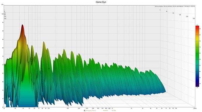

Of course, several REW measurements and speaker relocations have been made. The room suffers from a terrible mode at ~45-46 Hz, and no amount of room treatment will tame that realistically. So I am now using a (sacrilegious I know) DSP cut at that frequency to make sure it doesn’t make the sound too muddy. Clarity did improve, but the sound remains lifeless and congested, for lack of better descriptions. Several times I’ve thought to throw away everything, get some crappy digital speaker and call it a day…

The main difference with that room is that it has no openings (once you close the doors), slightly irregular shape and a ceiling of 3.5 meters. Reverb time is huge (RT60 = ~900ms) vs mine at ~450ms, but it seems not to matter. You just play music and enjoy it! Of course I can notice some limitations in the “finesse” or detail of the speakers, but again it doesn’t matter. The sound is much more open and I feel confident that if I start upgrading the components on this system and in this room, the improvements will be much more obvious. So why is that? Obviously, the symmetry of the reflections helps a lot to establish the image. But in my system I can never get this clear rhythm that you get from the drums to get the music going…

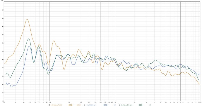

Being an engineer, of course I should follow a methodical approach to get to the root of the problem. So over to my friend go the Dynaudios. Time for some measurements first. In terms of frequency response, here are the Dynaudios (toed in) at my place (orange line), the Dynaudios (Green) and the B&W (blue) at my friend (no toe-in there). The curves have been SPL aligned by REW at 500Hz, 4-octave span. You can see how bad my room acoustics are! B&Ws also seem flatter overall. Their lower LF output is actually a blessing as it doesn’t excite the 47Hz room mode that much. They are also front ported which seems to make the in-room placement easier. I didn’t spend any time to optimise the Dynaudio position, which seem to be more picky for extracting the most out of them.
Let’s play some music then. Comparing the two speakers back-to-back, it’s obvious that the Dynaudio is a more “adult”, mature speaker and you can feel its authority. Definitely darker in tonality, it is missing some spark of the B&W. More importantly, though, it is missing the PRAT! I can see it’s potential to convey many layers of information, however they all fall on top of each other and in the result is completely unengaging! 10 times more expensive speakers and yet so disappointing result. And it clearly has to do with how the drums are emphasised in the B&Ws and give so much rhythm. It’s clear to me now that the Dynaudios need a much much better front end to show what they can do.
Final trial: the B&Ws at my place. No optimisation of speaker placement, but still, the shortcomings of the room are obvious: no special 3D image and the right speaker is always a bit more obvious. However, the PRAT is there! I keep playing song after song and they are all so enjoyable. I’ve never felt “We are the champions” and “Another one bites the dust” like that in my whole life!
