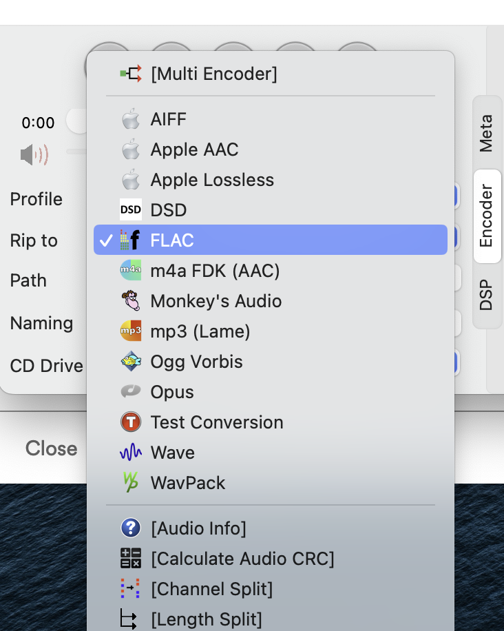

If I do that, which option do I pick on DB Poweramp? There is no .WAV in the menu! Presumably it’s the “wave” format?
Wave = wav.
