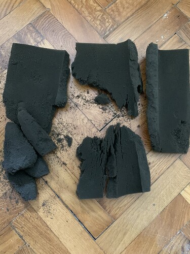

On the picture showing the driver just dismantled you can see that the foam lip holding the membrane has broken in most part or it’s circumference. The material has become very fragile and broke apart just by looking at it. (The second driver did not brake upon dismantling but I assume the material is as compromised as with the first one) both drivers are now on their way to ATC for reconing. The foaming inside the cabinets you can see are turning to dust …

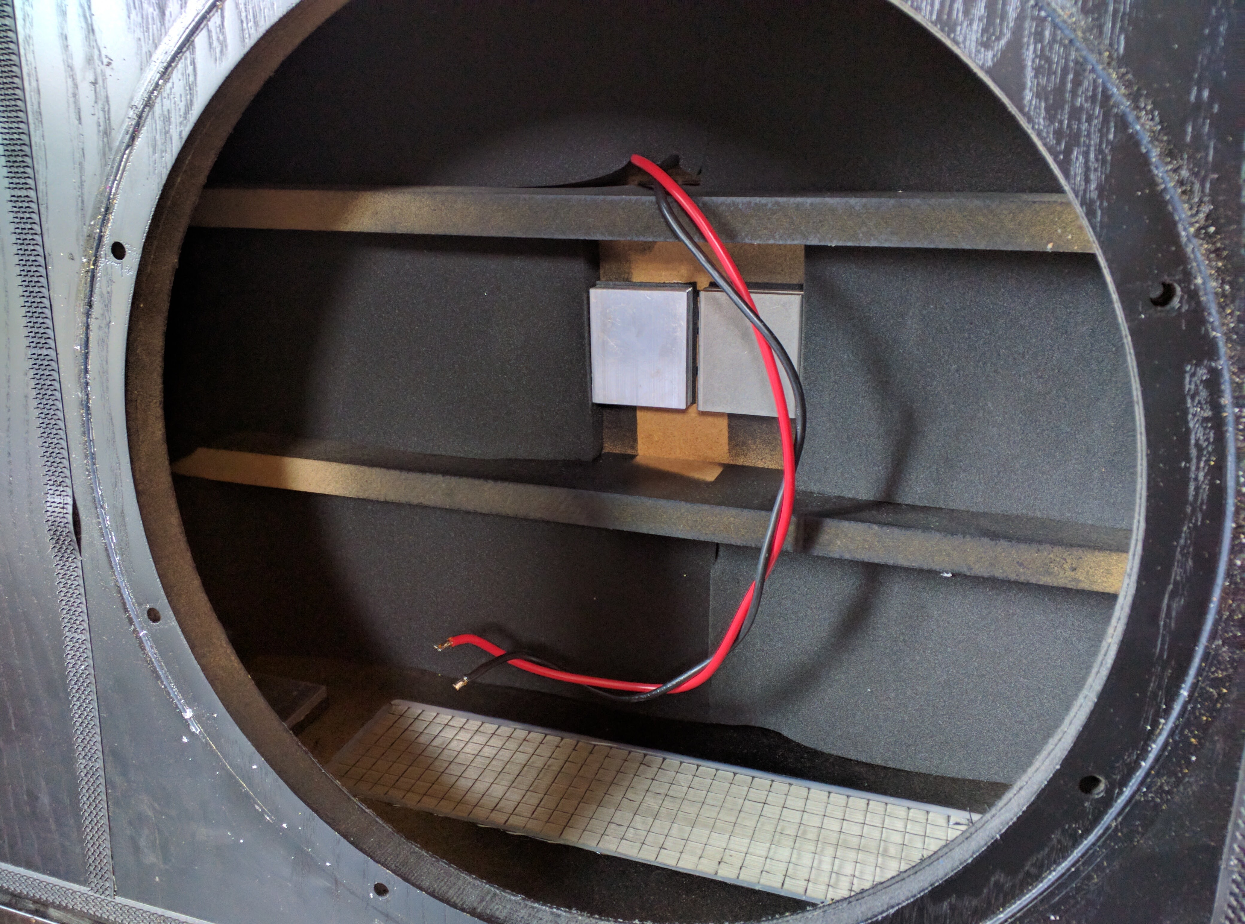

Photo of the foam in one of the bass boxes of my 1994 vintage DBLs. As I said earlier no sign of any degradation.
Willy.

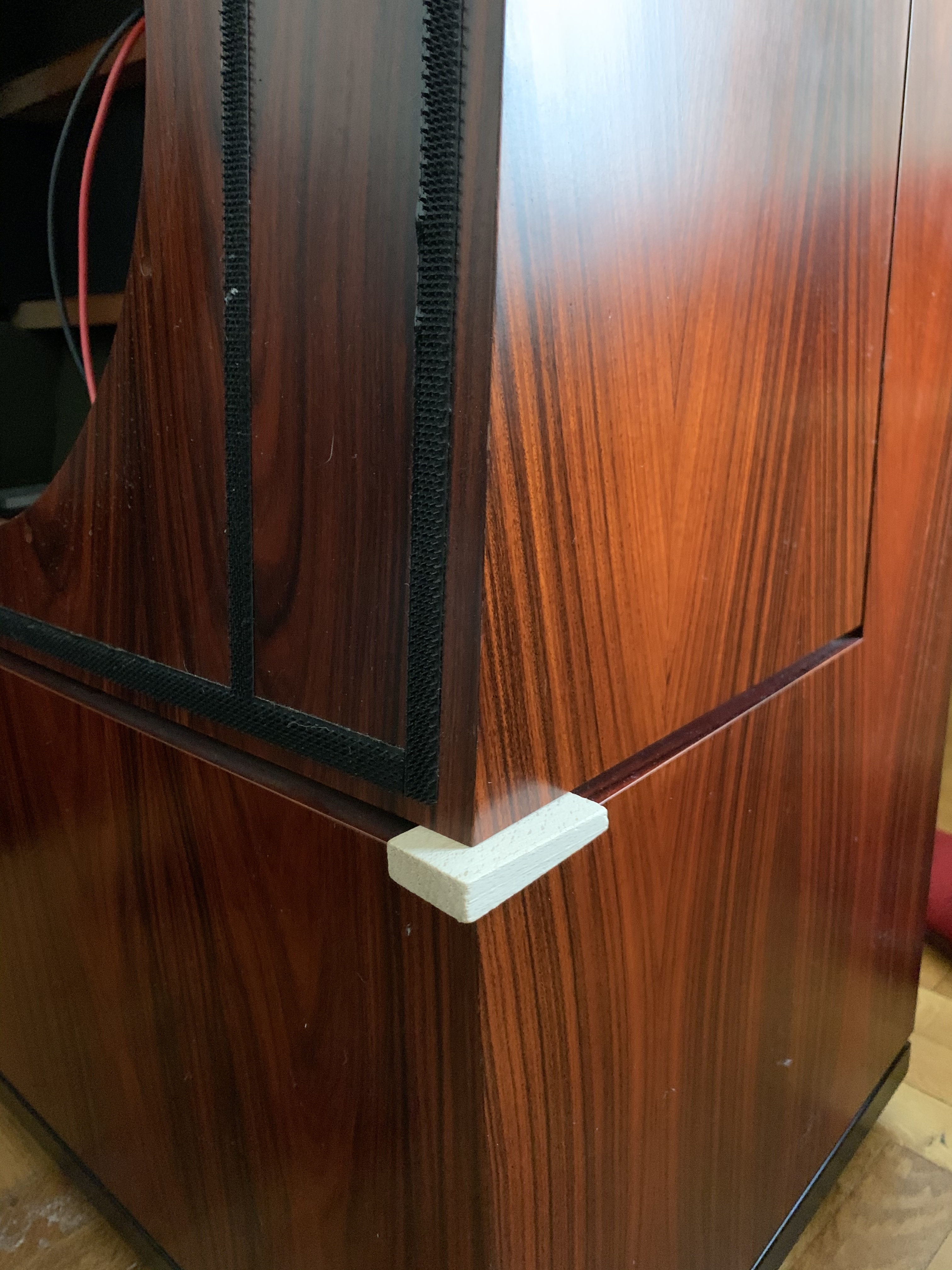

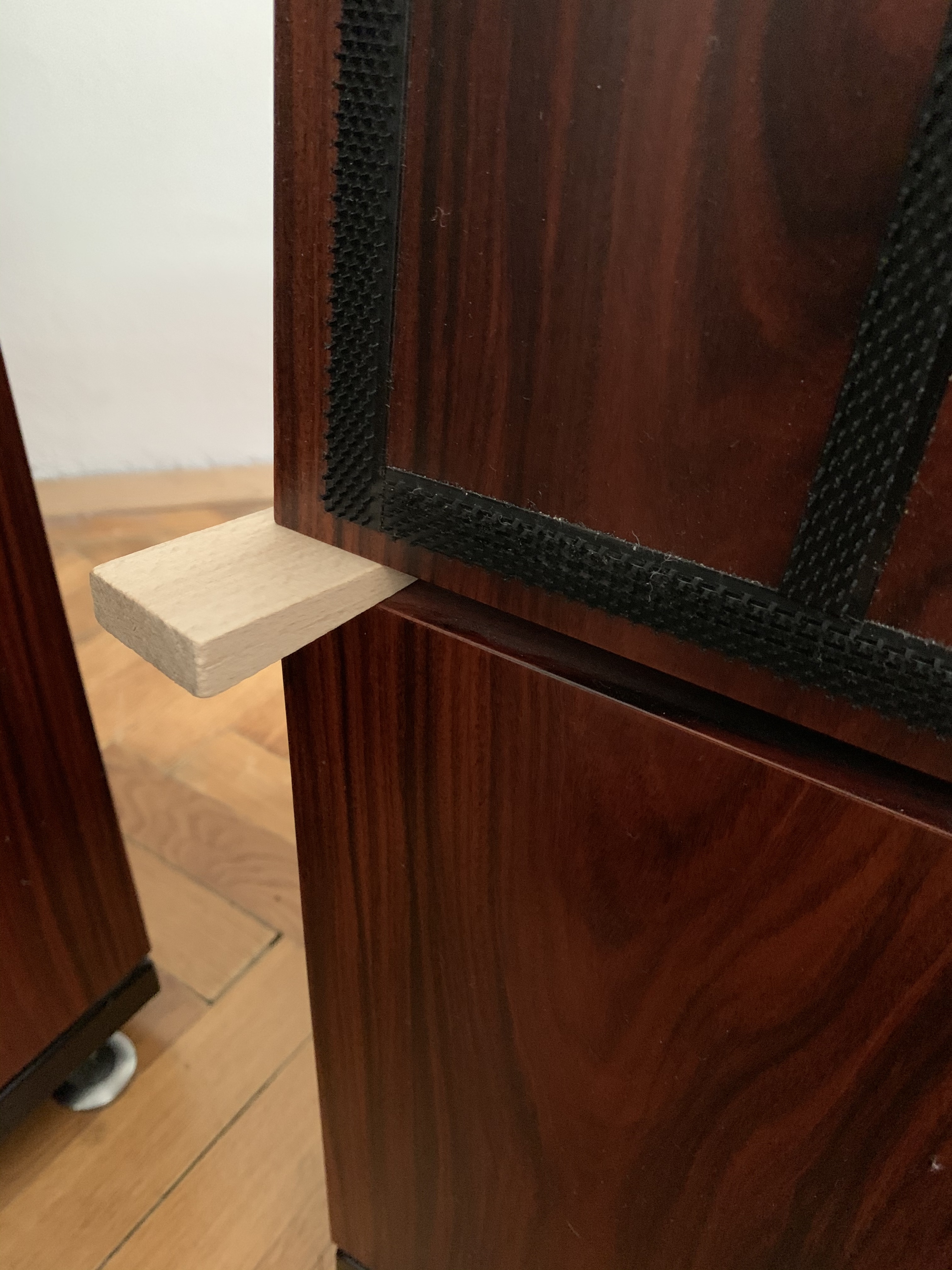

A bit off-topic, but can someone explain to me the best way to dismantle the bass box i.e. the best way to detach the silicone seal, without damaging the box?
I use some wedge shaped wooden blocks and gently push them underneath
Can send some pics later :+1:
much appreciated Charlie
Stefano
That’s my way doing it
If you apply some detergent prior to silicone the seal comes of very easily :wink:
Thanks Charlie!
and wonderful veneer :slightly_smiling_face:
Some more foam remains from the pillars of the bass cabinet feels like the scrolls from the Dead Sea
